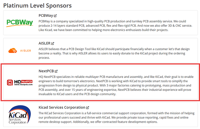

Why do you need a huat-cutter distribution?
Huaqiu has been a KiCad Platinum sponsor since 2023, and …
But it’s not mentioned on:
Here it is:
Ah indeed, after a bit of clicking, I see:
referencing:
