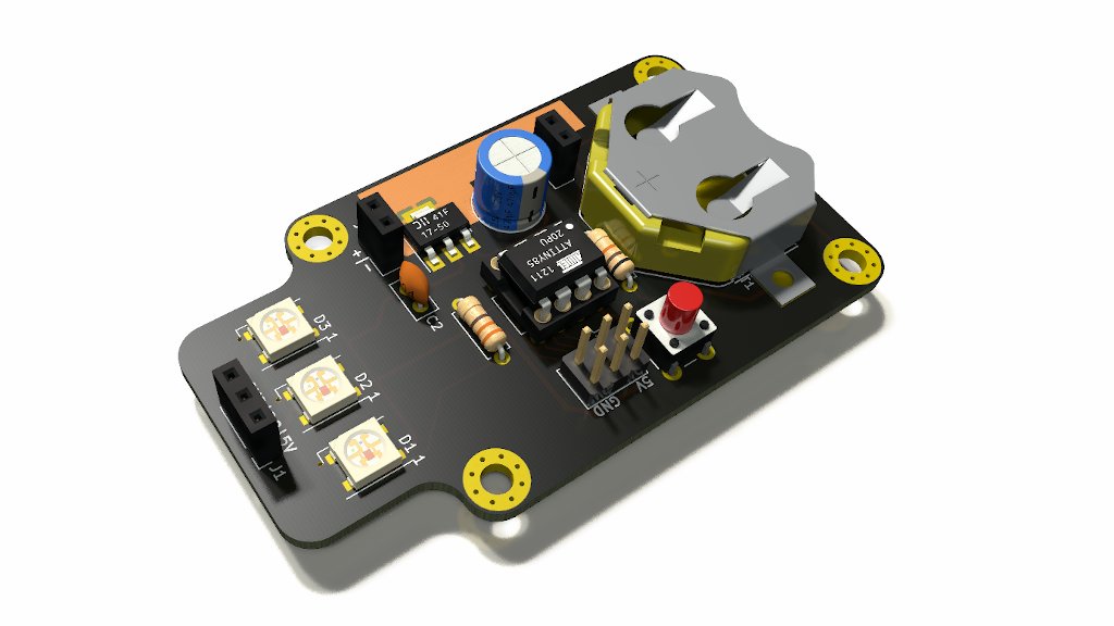

I’ve been putting off using Blender since over 5 years, being intimidated by the complex UI and workflow, until this month when I mustered courage to go through Andrew Price’s Doughnut tutorials. My aim was to learn how to do photo-realistic renders of KiCad boards.
I started off with the Open Hardware Summit 2020 badge (which I had a bit role in designing). KiCad’s in-built ray-tracer does a decent job, but there is no way to adjust lighting, background and other parameters. This is what it looks like in KiCad.

Unfortunately, KiCad raytrace option does not allow us to set lighting, floor and other scene parameters, hence Blender. So my next step was to export VRML and STEP file models from KiCad.

One important difference between the raytrace render as seen in KiCad v/s the exported VRML is the “MASK” layer. Look at the “W” in the OSHW logo and the “qwiic” logo. In the KiCad design, there’s a mask opening over these elements so that the underlying Copper/Gold is visible in KiCad 3D. In the VRML export, this mask window gets covered over. So the VRML export from KiCad is not a faithful representation of the board.

A workaround to this that I stumbled upon is to use the online 3D file format converter at CADexchanger and convert the KiCad VRML file to a Collada DAE format. Importing the DAE format in Blender results in glorious color renders.
COLLADA DAE import in Blender
Google Photos
And now we can fine tune the colors, roughness (shininess), subsurface (internal reflectance / translucency ?) for the PCB fiberglass material (PCB edge), mask, copper, silk, adjust the lighting, change the background etc.

So the workflow looks good now, and it’s possible to get nice renders using Blender. At the moment, render quality is only hampered by my very limited knowledge of Blender (about 2 weeks old) - so more experienced Blender power users will be able to do much better.

I figured out an easy workaround to the mask opening over copper areas issue for VRML export from KiCad.
For any footprint with copper area that needs a mask opening (such as Logos, which typically won’t have any pads), the solution is to edit the footprint and add a copper “anchor” pad. The pad doesn’t have to be numbered or assigned to any net. Adding a small SMD pad is sufficient.

Yes, the parts you marked are the ones I was referring to.
Problem with the last render is PEBKAC - I still have to learn a lot about the lighting and rendering part. But here’s a better view.

Now you need to check on the placement of the qwiic logo. It appears to be shorting the I2C lines in your render. (And looks larger relative to the other board features compared to your previous renderings in this thread.)
But kudos on finding a workaround.
Logo shorting the tracks - yes, indeed. I was just focussed on solving the immediate problem (but I fixed it later).
While I was at it, I redesigned the footprint from scratch via FreeCAD stepup tools, which is also why it appears larger in the latest renders.
