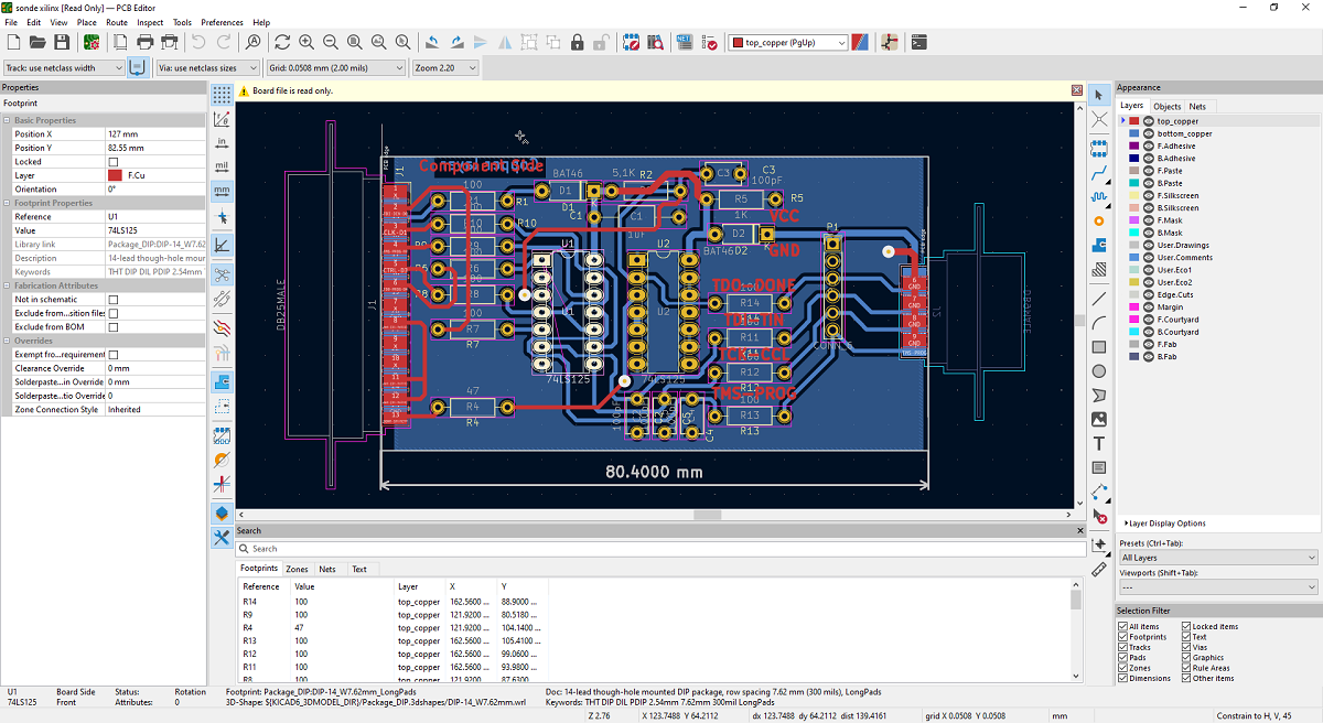

I’ve created copper fills on the top layer as a heatsink for my ICs, with vias connecting to the ground plane below (not shown). As you can see on the left, the FreeRouting software is routing traces across it like it’s not even there. What is going on?
Copper fills are usually just that, fills after routing is done. Perhaps you can route a copper track around the perimeter of the fill to keep auto routing out of it?
Seems ridiculous to me that you can’t make any PCB routing considerations before the autorouter. There’s got to be an actual way to do it. What about keep out areas? Is that a function in Kicad? Would that work?
Did you associate the copper pour with a net when you created it? It looks like GND but I want to clarify just in case. There is one fork of free routing that has a developer who frequents the forum. You might want to do a forum search. If this is actually broken behavior he might be willing to look at a fix.

I have over 100 output pins, I’m not going to route them manually, that’s absurd. Yes it’s labeled as GND.

From your screenshot i would guess you are still in the legacy (default) canvas. No wonder you think eagle is better than kicad if you use this old stuff.

Yes keepout areas are supported by kicad. (The button directly above the zone button. At least in open gl canvas. Not sure about legacy/default)
I sadly do not really know what freeroute supports. But this should be an easy test to do for you.

Duplicate the ground fill as a keep out zone
I tried that actually. It completely ignores the keepout.
I’m confused, are we talking about Freerouter or KiCad autorouter? The version of FreeRouter I use doesn’t seem to handle zones well, there are a few different versions around.
