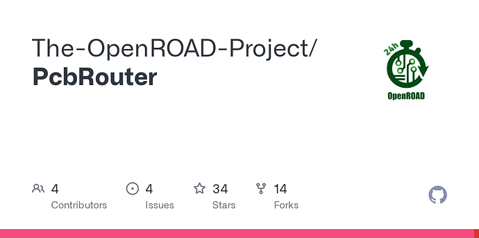

just for reference, there is an interesting project:
Unfortunately development ran for a year and then dormant for a year.
Anyway, interesting as at least its not written in Java
it would be nice if some of the devs could have a look at that project…
The-OpenROAD-Project seems a very active and sponsored project
… working on an autoroute with kicad could be a game changer also for kicad

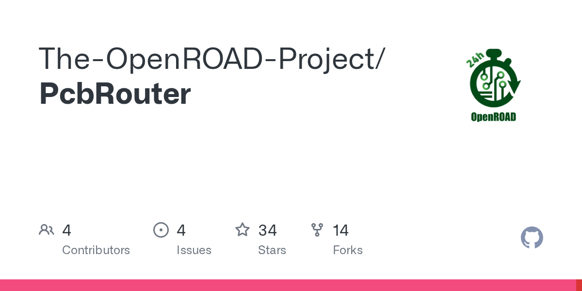

OpenROAD is talking mainly of chip design but not only…
here the repos for PCB design:
The-OpenROAD-Project/KicadParser
The-OpenROAD-Project/PcbRouter
The-OpenROAD-Project/PcbDecompaction
The-OpenROAD-Project/PCB-PR-App
