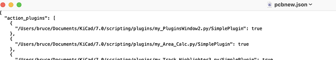

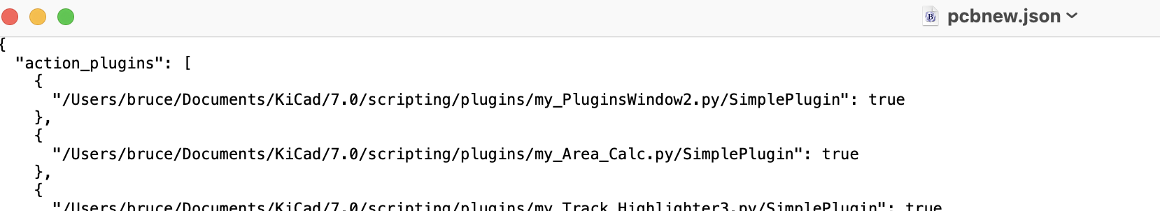

There’s also the .json file that contains the info…
Can easily write a Python/etc script to read whatever file you want to use that contains the info…
I still use v7 so, can’t look to see what newer .json post but, you get the idea…
