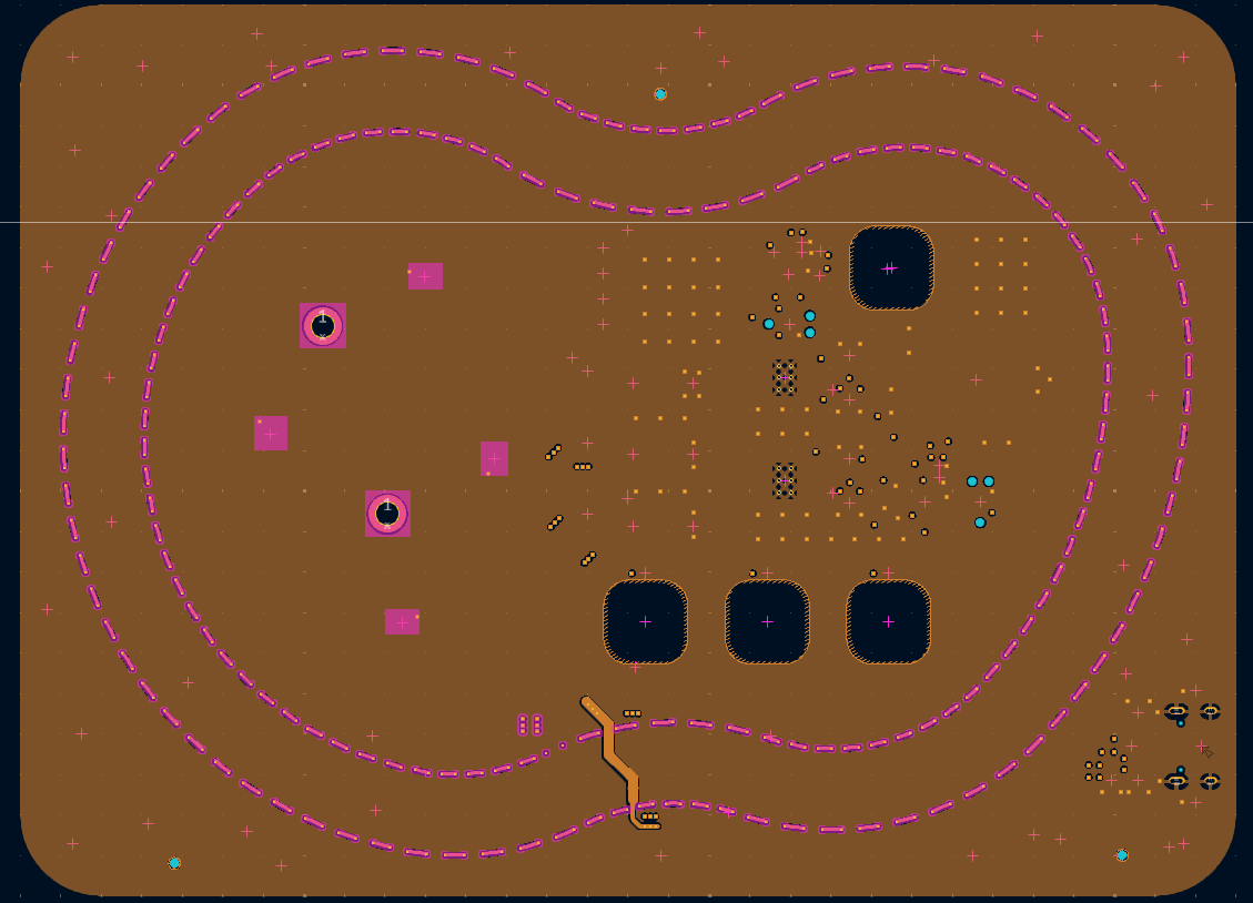

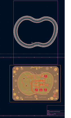

If I open up the file in v9.0.5 and look at the GND pours on L1 and L2, this is what I see:

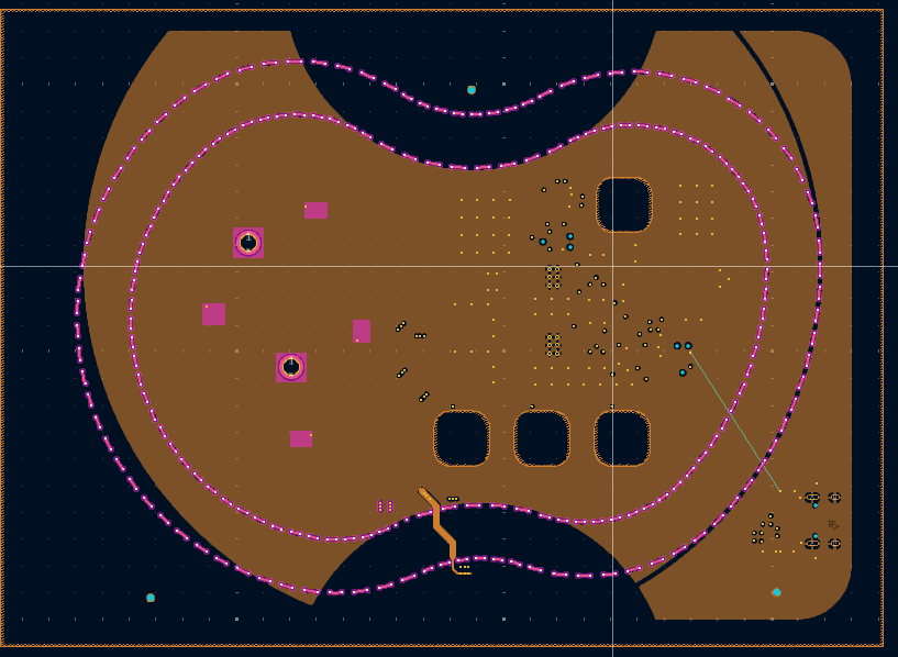

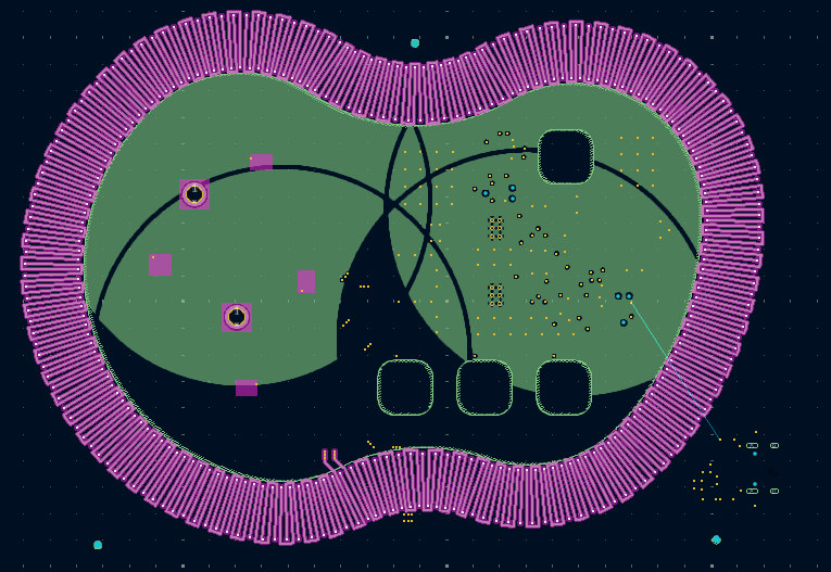

But if I do a rebuild (B) of the pours, this is what happens:
I’m not actually saving the older files before I do the rebuild. And if I delete the pours and then redo them, I get the same weird shapes and islands showing up.
I can’t for the life of me work out what’s going on.
Anyone got any ideas on how I can fix this?

Weird. I don’t see the reason, yet, but I have V8.0.9 and V9.0.6 on my machine and can confirm that redoing the zone pour in V8.0.9 seems to work AOK, and redoing them in V9.0.6 makes the same goobers you’re seeing. It’s like there are conflicting overlapping zones or keep-outs or … but I can’t see them. Looks like an interesting puzzle question that’ll I poke more at if I get the time later this evening. If someone else doesn’t unravel it sooner.

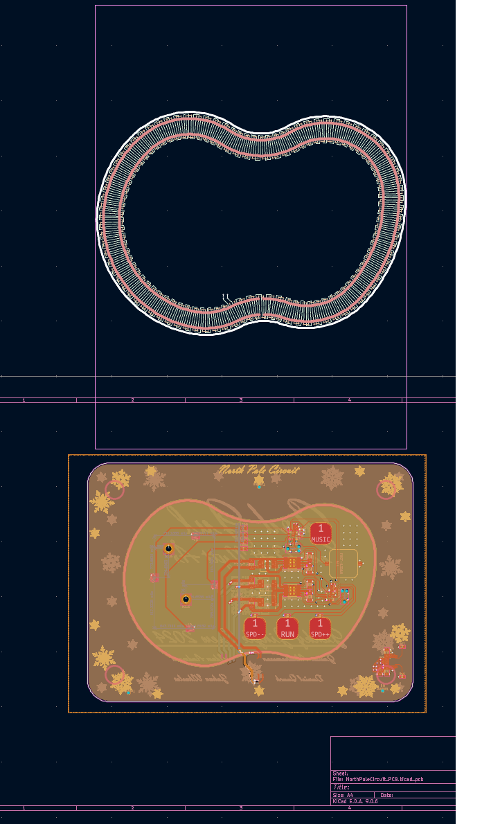

Seems to be something in the inductive sled tracks / guard rail feature. In the V8 file, this feature has been make into a group and if I move this grouped feature off board, then the inner-layer pours seems to pour fine in V9.0.6. Another clue is the size of the group box- It’s much larger than just the supposed sled track loop feature suggesting there is something hidden or invisible grouped into it along with the visible features.

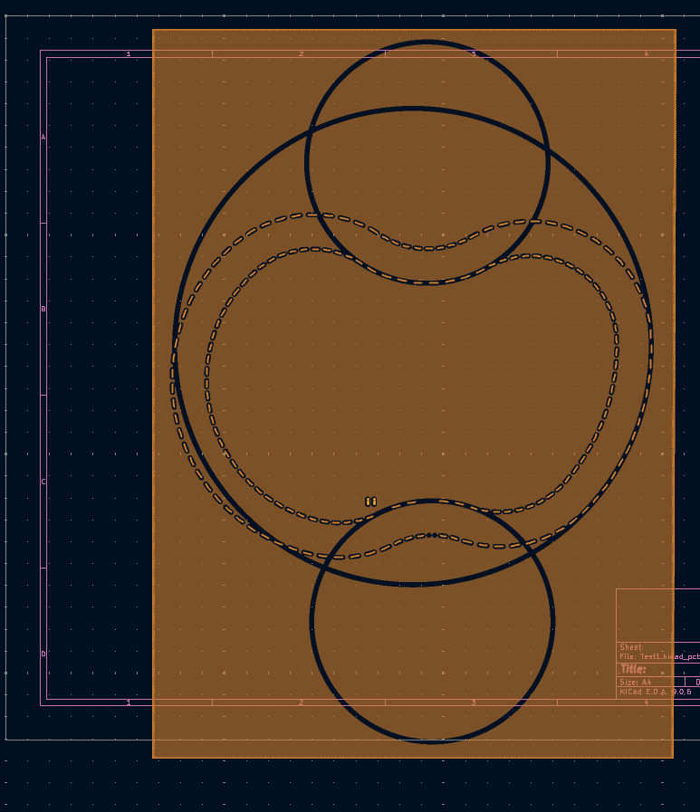

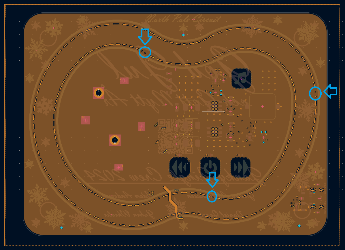

Trying to reduce / isolate this odd puzzle piece further, I’ve reduced it to focus on just one goober on one zone pour In2.Cu. When the short trace segments on In2.cu on the sled track are removed, the zone pour on In2.Cu works as expected. When they remain, there’s (3) distinct circular voids in the pour zone. Quite odd. I suppose I’ll move on to looking at the ASCII s-expression raw text file to learn more- If someone else doesn’t distill an root-cause answer sooner.
@DaveL - there is a Python script in the repo that this design was originally spawned from. That was used to generate the track layout that provides the forward/reverse propulsion.
Wondering if that’s introduced something into the KiCad file that v9.0.5 isn’t dealing with.
Those weird curves seem to be defining the track path in some way.
I am guessing the other way around.
All the anomalies seem to be from circles or arcs. My guess is that the python script has some latent bug that inserts too many arcs onto the PCB, and that these arcs do not show up in KiCad V8 (maybe they are malformed?). And then that KiCad V9 interprets the arcs in a different way, which makes them visible.

Staying with focusing on just one layer (In2.Cu), I reduced the trigger to just (3) short segments. Each one of these short segments seems to trigger each one of the (3) phantom circular voids in the zone pour. With all (3) removed In2.Cu pours just fine. When I replace these short segments with a short free angle route, it also now floods fine in V9.0.6.

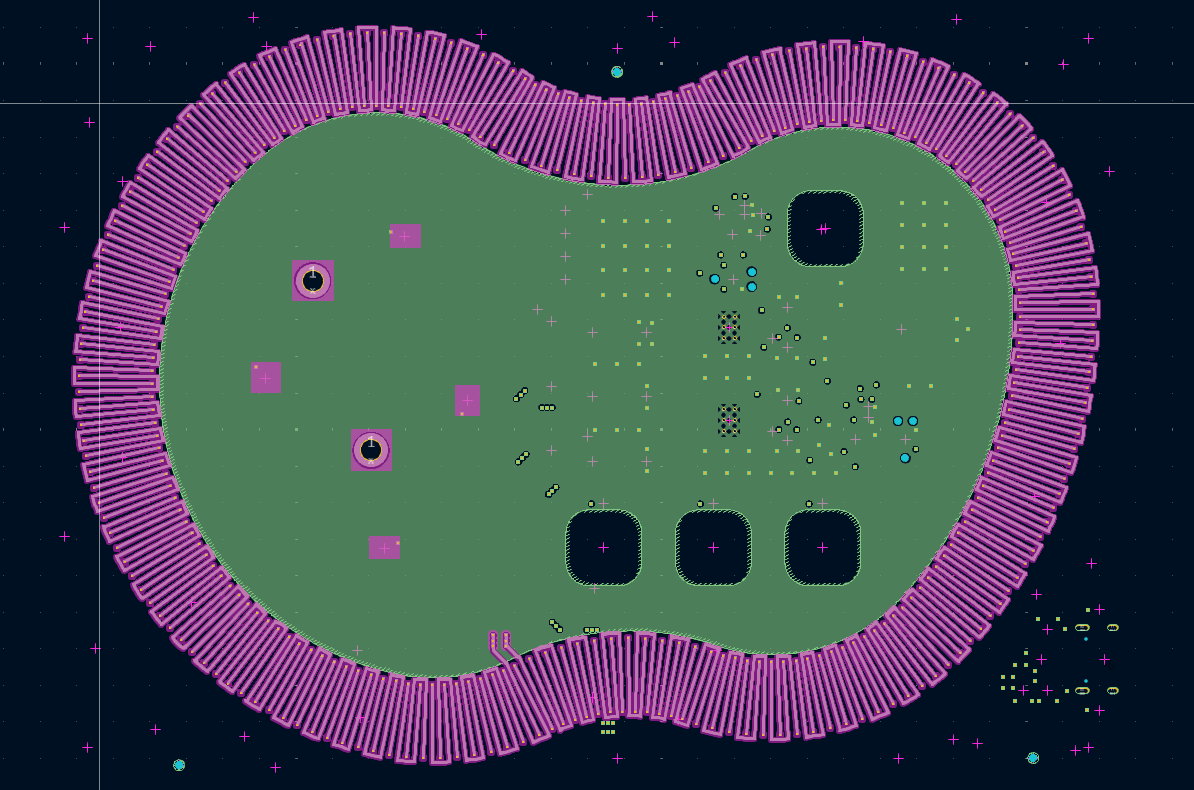

By ‘trigger’ I mean identifying the thing that causes something. It’s basic troubleshooting that progressively divides the problem into smaller and smaller parts or groups until you’re at the smallest thing you distill it to. In this case, seems it’s a few to several small arc segments with a very shallow arc radius relative to length that V9.0+ isn’t happy with, but V8 and V9.0.0 was.
By trial and error and whittling the problem to the smallest, then redoing those that trigger the issue, see the attached. Give it a go in V9. Ho Ho Ho.

Similar to what I’ve showed I did on In2. Identified the segments that seem to trigger the large circular phantom voids then deleted them and redid them. Note I didn’t replace any of the short segments with arc traces, just short free-angle segments. All of the traces in the sled rail are defined as arcs, but the arc radius is so shallow they’re effectively straight anyway. Esp the short segments.
