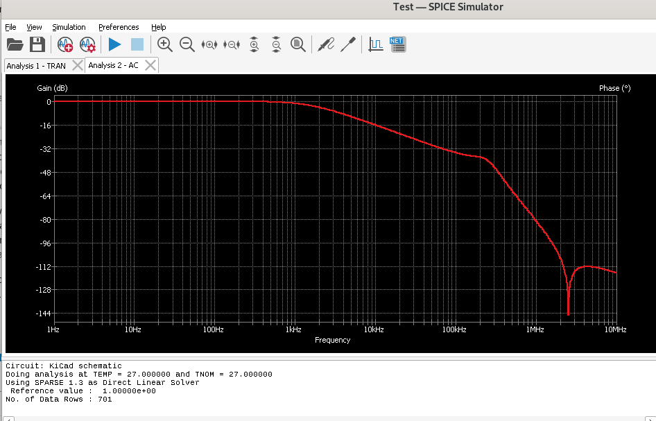

I’ve got an AC stimulus going into (for this example) an RC low-pass, really nothing complex. The transient analysis works a treat - although it’s slow to chart compared to LTSpice running on the same machine.
1Hz to 10Meg, nothing… 1K to 100Meg nothing… It’s really weird because I’m sure I ran some more complex simulations in KiCAD 7 without an issue. I’ve got an issue I need to track down and simulation is the only way I’m going to find it in this lifetime. One or more of the op amps on my board is running into a capacitive load. (Maybe parasitic, maybe I’m an idiot - you can take a guess…) . and producing a lovely 4 MHz sine that’s so nice, you’d think I’d designed it using a precision LC tank or even a DDS with a decent 16 bit DAC.
But on AC — I’m drawing a blank - literally, no chart nothing, even even tried entering the range backwards to see if that changes anything. Same effect - when I click run simulation the stop button flashes as if some code has run but that’s all. Now the ONLY thing I can think of that might be “throwing a lump of molten solder in on a live PCB” is that on Debian KiCAD is in one of those Flathub packages which have upset other software in the past. Debian only packages up to KiCAD 6 and that’s like going back to wire wrapping and manual tape. Man this software develops at a pace and I’ll be delighted to send some more filthy lucre your way before year’s end 2025.

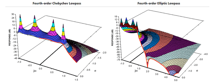

On a related note, can someone explain in words that this idiot can understand with my appalling knowledge of vector calculus, how I set up a Pole/Zero simulation and what it does? I know what they are, but I’m unclear what sort of simulation I would use them for. I’m very conscious of capacitive loading and I’m usually far more careful but I’ve slipped up this time and Pole Zero analysis sounds like it may help (even if I have to break the loop with some 1T inductors and 1T caps like Texas Inc. suggest.

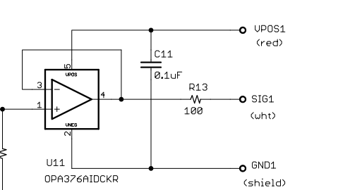

Not a reply about the simulation, but to decouple a capacitive load, on an opamp (like driving a guitar cable) try a small series resistor (try 10 to 100-ish ohms) in the output. Best to use a buffer (not gain) config for this.

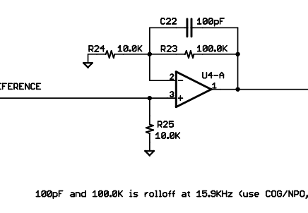

And if you are getting an oscillation, try adding a small cap across the feedback resistor – you get a first-order low-pass rolloff with -3dB at 1/(2piR*C) which you probably want anyway to band-limit your circuit.

Please have a look at KiCad Eeschema as GUI for ngspice, tutorial for setting up the simulation for a simple ac simulation.

I’d already done that (and more) unfortunately, but it does appear to be an issue inside the FlatHub version of KiCAD.
As a test I ran KiCAD for Windows under Codeweaver’s CrossOver (I assume it works in Wine but I wanted to give it the “best” environment).
And would you look at that. Same circuit, same simple simulation (I even added an op amp into the mix).
When I rebooted the machine from a cold start, the first simulation (literally an RC) ran first go but as soon as I added the op amp (the simple one from the internal set) “poof” not a dicky bird. Same thing in the Windows (under Wine) and it’s working a treat. Even showing things like that little peak in the curve at HF. I need to model the parastics to get this nailed down so that should see me right now.

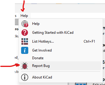

I have to wonder if some of the negative reviews KiCAD is getting on Debian are partly or wholly due to issues with FlatHub acting up? That would be an awful shame as the FlatHub isn’t maintained by your team as I understand and “bugs” caused by the external system aren’t your fault.
I’d file a bug report for this but I don’t even know who to tell!

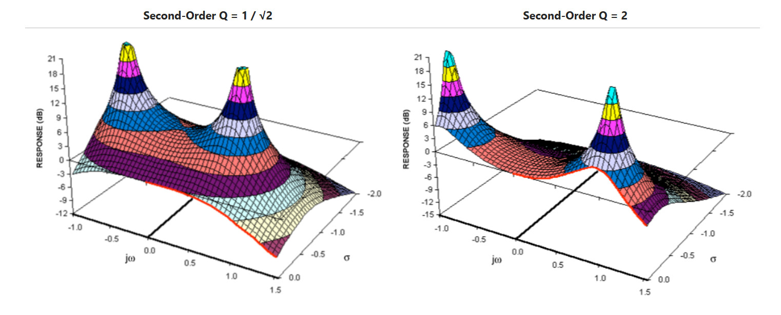

A quick bit of visual insight – to design an analog filter or processing block, the desired response is defined by a transfer function equation (that defines the relation of the output to the input) in the time domain. A Laplace transform converts it to a representation in the s-plane – this is the complex frequency domain where the horizontal axis denotes the real part (σ) and the vertical axis denotes the imaginary part (jω) of the complex variable ‘s’. In the s-domain, the transfer function is an equation that has a numerator and denominator: H(s) = B(s) / A(s). So, when the numerator B(s) goes to zero (at some specific frequency), the output goes to zero (exemplified by the stopband dips in an elliptical filter), and when the denominator goes to zero (at some specific frequency), well, recall that something divided by zero = infinity (yes, divide by zero is an error on a computer, but it is infinity) – this is a pole.
When the s-domain is plotted in 3d, you can see the poles (and zeros if they are used). When you slice down through σ = 0, you see the magnitude response (positive jω) shown as red lines below – which is pretty cool! You can see how the peaks occur as the response gets pulled up by a pole, or sucked down by a zero.
I find that these 3d graphs (grabbed from an adi app note) provide a lot of insight into how the pole/zero positions affect the response. Also note that a second-order filter has two poles, a fourth-order has four poles…
That is a wrong assumption. On bookworm (Debian 12) backports there is KiCad 9.0.2 available (see also Debian -- Details of package kicad in bookworm-backports). An instruction how to install a backports package is available at Instructions.
That’s probably due to wrong settings. Make TSTEP 10 times larger, and the simulation will be 10 times faster. As you did not give any details, this is just a guess.
Not a KiCAD issue, this seems to be related to the FlatHub package.
I’ll try this and report back when I get a moment. I’m starting to think I’d be better served running the Windows build under Crossover as that seems to run into few rakes! I can’t blame KiCAD for an issue caused by a packaging system.

AH! That’s where it’s hiding! Thanks @holger - that’s had me climbing the walls.
That’s really cool. I don’t have much of a mathematical bent (long story) but I had complex needs as a kid and ended up in the sort of school where skool was an accepted spelling if you catch my drift.
My introduction to calculus (such as it was) failed to point out - that or I failed to notice that the answer to a problem was often another function. Visual charts are so much easier to help me wrap my ageing brain around. I’m a writer by trade with a speciality in early computer systems and maths wasn’t something I needed. Per the Art of Electronics, I try to avoid as much of the maths where possible/practical but there are times - such as this one - where computers come into their own. I recognise poles and zeros on a 2D chart easily enough from the rolloff and phase characteristics but that’s only part of the problem as your graphic clearly shows! The ripple in the passband of a Chebychev is quite dramatically illustrated there.

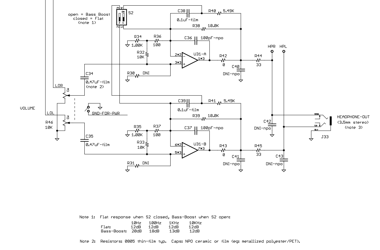

Yeah, I went down a headphone amp path a few years ago, curious about the simple cmoy and spinoff designs. The 5532 is one of dozens of good opamp candidates. I designed and built this and it works quite well:
Oooo that’s nice. You know your passives obviously. I tend to cheap out on X5R and thick film, at least for prototyping. NP0/C0Gs are so expensive by comparison and I dread to think what thin film cost … but there’s no question that they are better in audio. Essential if people are demanding “hi fi” now. Although I’m often amused by HiFi buffs who claim they can tell (for instance) if a mixer used 741s or 5532s or something even more esoteric. Douglas Self designed professional consoles in the 90s with TL072s (the original with its phase inversion issues no less; and running at +/-17V even though it’s officially only specced to+/-15.
The one I did used a bunch of 5532s in parallel for better drive performance into professional headphones. Totally over the top of course. :slight_smile: Can’t say I’m particularly proud of it though as I was still learning layout at the time. Not that we ever stop learning. I joke to the kids that they’ll cremate me with my entire reference library which ranges from biology to psychology, computing, and, electronics naturally. They complain that it’s all online now (a lot is) but there’s a lot of stuff online that ranges from poor to outright lies - and AI is vacuuming it all up and spitting out more of the same rubbish.

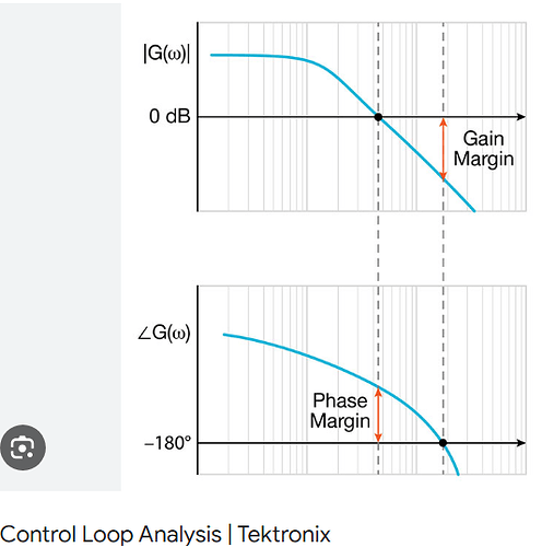

Opamps in parallel will give you more drive current, and the noise floor drops as the random noise from each amp averages it down, but it is a tricky business to keep stable. A little series resistor in each opamp output will be your friend. Bandlimiting is also a good idea – 100pF or so across your feedback resistors – when you have an oscillation (like the 4 meg you see) it means you have insufficient phase/gain margin. An opamp circuit is a control system and all that stability stuff applies. Add that little cap to push the lowpass corner down to a reasonable point, the margins improve and the oscillation stops.
And what does that mean? Well, regardless of whether you have an non-inverting or inverting opamp configuration, a closed loop opamp circuit (as opposed to using it open-loop as a comparator with hysteresis resistors), is still a negative feedback system so there is 180 degrees right there. Now as the graph above shows, as the freq increases, the gain is flat for a bit, then hits the lowpass corner and starts dropping. It had better hit 0 dB (where it no longer has gain) BEFORE the the phase droops to 180 degrees. The 180 degrees of the closed loop feedback design, plus 180 degrees of phase shift from your external RC topology equals 360 degrees (think of it as 0 degrees), and if the circuit has gain at that frequency you have an oscillator (with positive feedback now).

The issue of phase margin is quite a fascinating topic. I tend to work in the time domain (by hand) to see what sort of delay the load capacitance will cause. I think of it as the time it takes the output drive to charge the cap causes an error in the feedback loop.
LT (Analog) did a very interesting video on using a single 0V voltage source to isolate the inputs rather than using a 1TH inductor and 1TF cap. With a simple (V/V) trace on the graph you just find the 0dB point and read off the phase margin.
