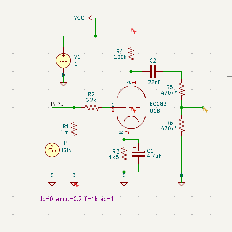

I have been working with Kicad 9.0 for quite some time.
I am mainly interested in tube circuits (12AX7 and others)
I tried to figure out the simulation to apply, for example, a sine wave to the input and examine the simplest circuit.
But I can’t correctly connect the power supply, input signal generator and control (like an oscilloscope) to this circuit.
I understand that I am writing incomprehensibly for specialists).
Nevertheless. Can someone help with an example of the simplest circuit?

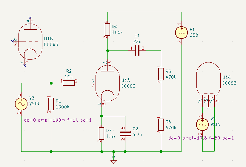

This would be my suggestion. Note the value of R1. You have 1 milliohm!
Don’t forget to find a model for ECC83 and store it in the symbol. My input source is wrong, sorry. Just use yours instead.
