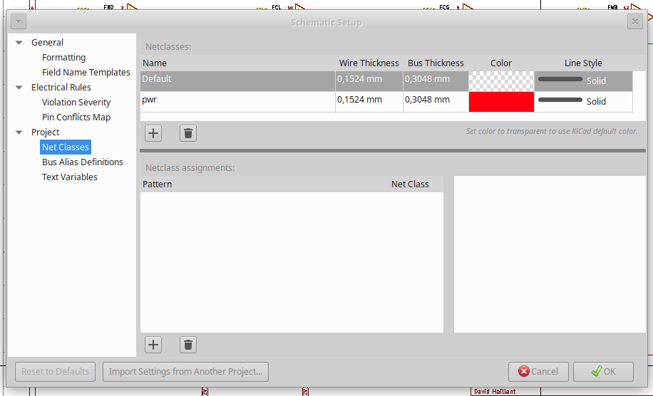

I’m testing 7.0 rc2 by opening an old project.
I’m wondering why the Net Class table is empty in Schematic Setup window?

Did the project have netclasses defined previously? If so, please report this as a bug and attach the project.
Assignments of nets has changed from V6 → V7. In V6 and earlier you manually put each net in a net class, while in V7 you create “patterns” and net classes are assigned to nets based on the created patterns. You can create / edit these patterns both in the schematic and PCB editors.
I don’t know the details, I have not used this much myself. I also don’t know if this can cause conversion problems with old schematics.
Well, this is the same project on V6:
Oh, I wrote “Net Classes” but what I don’t find in V7 are the “Nets” which I suppose should be listed in the same table as in V6?
Please report a bug with this project. We should have generated a new assignment pattern for the +12V net to pwr netclass. cc @JeffYoung
The UI has changed so you no longer expect to see a list of nets, but the list on the left (with netclass pattern assignments) should not be empty for this project.
I’m seeing the same here with an older project opened in V7.0.0-rc2. It has 6 net classes of various widths, but the “pattern” area remains empty. I did not even realize it was a bug because I’m unfamiliar with this new pattern assignment thing.
I can add a pattern, but I have to add a slash in front of the net names before KiCad recognizes them for netclass assignment.

So, we haven’t been able to reproduce the problem.
I suspect there are some precise events that could trigger this issue.
Also, I had, in an other project, twice the “Default” netclass.
Closing and reopening the same project, only one Default netclass is now present.
@paulvdh if you have a design that reproduces this problem in the latest nightly, please add it to the (now-public) issue since we haven’t yet found out how to trigger it.
