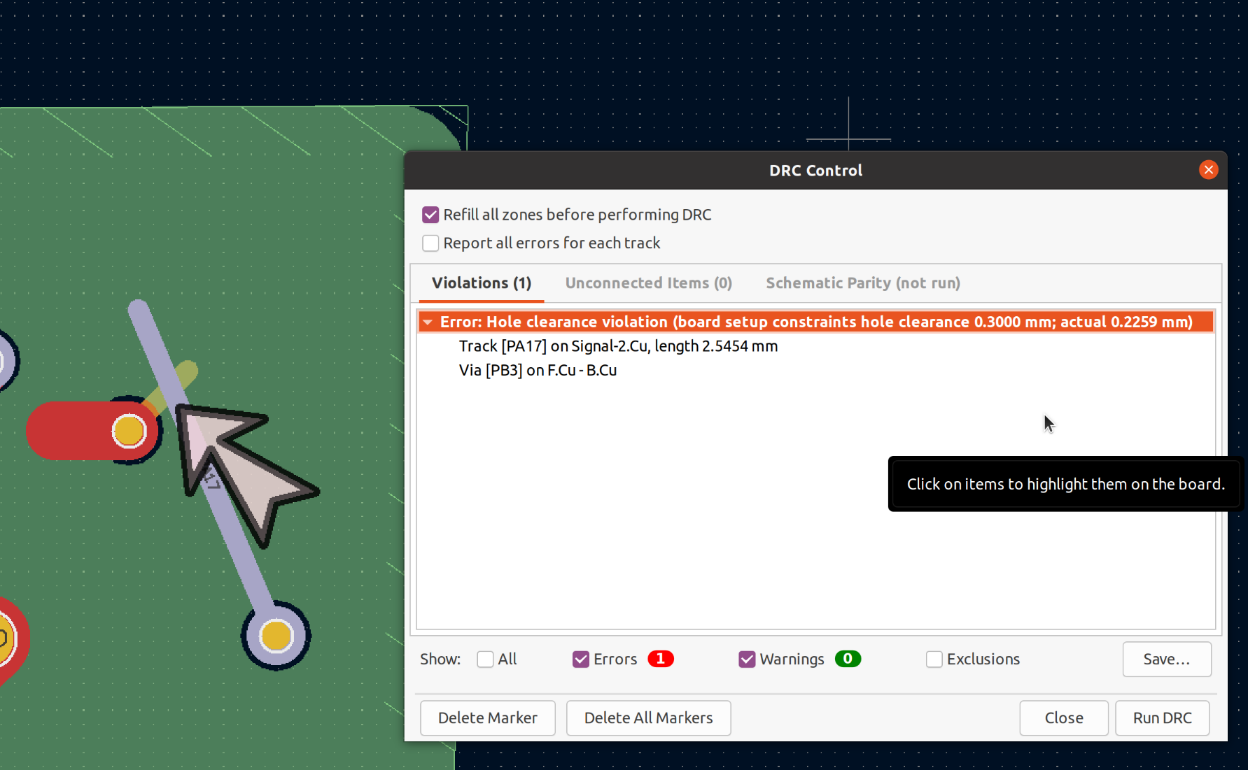

It would seem like the bug depends on additional conditions that Jeff didn’t consider? Or maybe I’m missing something? This is a screenshot illustrating that the bug is still present — same layout file I posted, opened with the newer version of the nightly:
Immediately after taking that screenshot, I took this one:
Someone shed some light?
Hole clearance runs only on NPTH holes. It’s not run against vias (or pads with copper annular rings).
Well, that is a bug, isn’t it?

Additionally to this: there is an inconsistency between the actual functionality I’m observing in 5.99 and your clarification above: the copper-to-hole is applied for plated-holes to traces separately from the general “Minimum clearance” (which the icon shows as distance between two traces). You can see the DRC message, specifying that the distance from the hole to the trace is 0.22mm while the requirement is 0.3mm; I set the “Minimum clearance” to 0.1mm, so that one is not being violated (yet the DRC is still flagging the via-to-trace < 0.3mm).

The lead dev team discussed this and concluded that testing all holes was more likely to meet expectations.
New bits are up.
