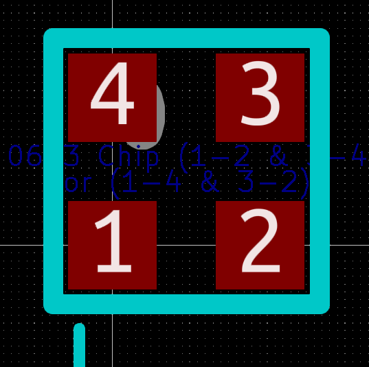

I do such crazy things with SMT. I have one 3 pad footprint which accommodates one of two 0603 chip resistor locations, and a 4 pad footprint which accommodates two 0603 chips in X direction or two in Y direction.
BTW if you are going to make a pcb, you really ought to dive into SMT. I have been engineering since 1975 and was initially intimidated by SMT. But if you avoid the fine pitch parts, it is not difficult and it has many advantages. The main disadvantage of SMT components is for hand wiring…but you are making a pcb.
