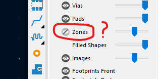

Is it this ?
Thanks! That was the issue.
