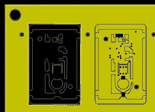

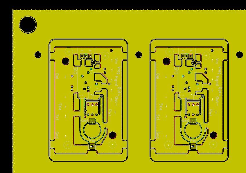

I’m trying to create a stiffener layer of a flex board in a panel pattern. I finally figured out that zones only follow edge cuts if it’s a copper layer, so I had to add another copper layer to this 2 layer board and use one of the extra layers for the stiffening layer.
Anyway, when I fill the zone, it avoids the edge cut through holes, but it does not avoid the coupon even though I drew lines… it goes inside of the coupon and seems to only avoid the lines…not inside of the coupon.
Below, the first picture shows the zone filled …and the second pictures shows the zone before it’s filled. Thank you!

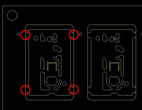

Below is just the edge cuts layer…
I want a cut out around the circuit board and it’s 4 tabs, except I want it to follow the rounded corners. Below shows the zone with a manual cutout zone, but if I do this, the zone does not follow the rounded corners and I can only create a square cutout. I could add more corners and follow that contour manually, but it is tedious and lacks precision.

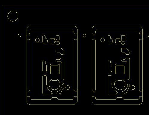

There are (for KiCAD) confusing edge.cuts there.

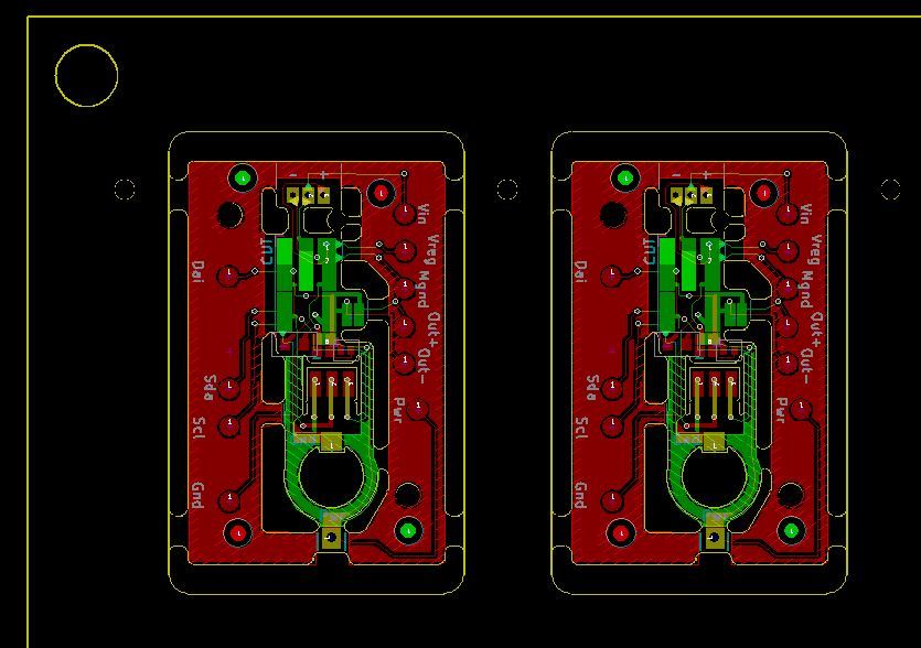

From the 2nd image I take it the stiffening essentially is just for the pcb panel - the actual pcb you’re going to use will have no stiffening areas?
Your aim essentially boils down to having a rigid outer frame for handling of the flexible pcbs?

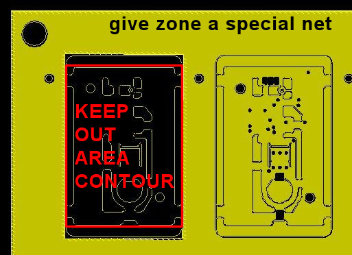

To actually help you with that zone and your approach:
You need to create a special net (net name 'stiffener maybe? :wink: ) in eeschema and some through hole component (as you use an inner layer) that sits on that net for the zone to correctly fill. This component then is placed somewhere on that frame.
You also need to correct the edge.cuts layer and remove those lines on the outside of the tabs - they need to look like on the inside - the keep-out area will take care of it. And you probably have to experiment a little, and check out different states of filled zones and keep-out settings for the gerbers.
If that internal pcb contains any filled zones, you could also use thin keep-out areas just along the tabs (= as wide as them).
The special zone will then only fill those areas where the through hole component ‘floods’ the area. It won’t cross edge cuts and also stop at keep-out areas.
