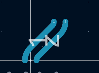

I’ve spend the last day creating a workaround-workflow for rounded/curved traces in Kicad that somewhat ease the burden. Thus far I have only implemented a curve that offsets the differential pair to the side (I call it Strafe, as we used to call sidestepping in video games back in the days). The footprint looks like this when opened in footprint editor:

  2. Call a python script with necessary parameters (diff pair trace width, gap, offset, etc)
  3. The script calculates the primitives of the wanted footprint, in this case there will be 4 arcs and 2 lines, negative offset means an offset to the left.
  4. The script creates the footprint file and names it according to the parameters. Provides calculated “pad to die” for each trace.

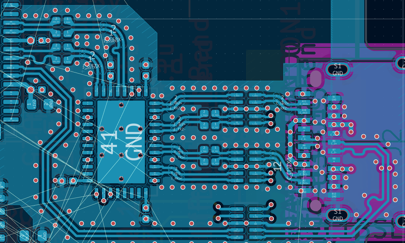

Far from painless, but at least the effort in creating footprints are now limited. The design below includes 8 (of which 2 are on the bottom side) Strafes/offsets + one 90 degree direction change on the USB 3.2 gen 1. I already had it routed using 45 degree bends, so once the python script was working alright, it took about 20 minutes to replace the hard 45 degree corners with rounded/curved ones. So, using this method, before starting step one the differential pairs shall be fitted in all possible ways using the normal dp router.

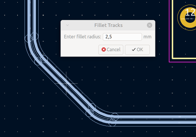

I just did an experiment in KiCad V8.0.9.
  1. Draw a differential pair. (or more).
  2. Select it (use the u key for selection etc).
  3. Right click, and from the context menu, choose Fillet Tracks.
As you can see, this works for the whole selection of the differential pair.

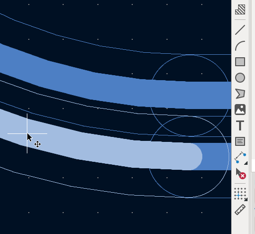

I was about to post along these lines. The only downfall is WHEN it rounds it doesn’t adhere to other constraints so there will small area’s where the distances will fail
When looking at my previous screenshot, I noticed that the start (end) of the radii from the horizontal tracks were not aligned vertically. A further test confirms both tracks of the differential pair get the same radius. As a result the tracks are not parallel in between the radii. With 45 degree corners the result is very small, but with a 90 degree corner it’s more pronounced.
For the distance to be constant, the arcs must have the same center point, but this is unfortunately also not so easy in KiCad. One way to get close quickly is to align the ends of the arcs with the side of the drawing canvas. Make the circles around the endpoints touch the vertical edge of the canvas. It’s not perfect, but it’s easy to get close enough.
