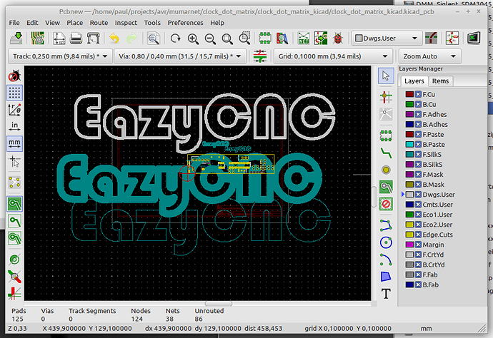

What is the size of your logo supposed to be?
I imported it a few times, and when imported with a scale of 1:1 it is 430mm wide.
In the screenshot below the paper size is A4.
As you can see, I can import with different line widths, but it seems to be truncated to whole millimeters.
I also imported it twice at a scale of 0.1
The fat lines are imported as 200.4 mm width, which results in 2mm on the PCB. So there is something fishy going on here.
After that I opened the .kicad_pcb file in a text editor and did a search and replace operation:
And it seems to work. The line width was changed to 1.232mm after a save and open in KiCad. By also searching for the parentheses and layer name, you get less false positives with the search.

It looks like there are 2 overlapping bugs. One is the truncation to whole millimeters, and the other is that line widths are scaled diferently when importing scaled DXF files. So a part of a workaround is to export your image in the right size from your other CAD program.

Still there seem to be 2 bugs in the linewidth during import:
Linewidth seems to be truncated first to a whole number of mm.
Linewidth seems to be scaled with the square of the “Import Scale” factor. In der.ule’s example a scale factor of 0.01 resulted in a line widht of 0.0001.
