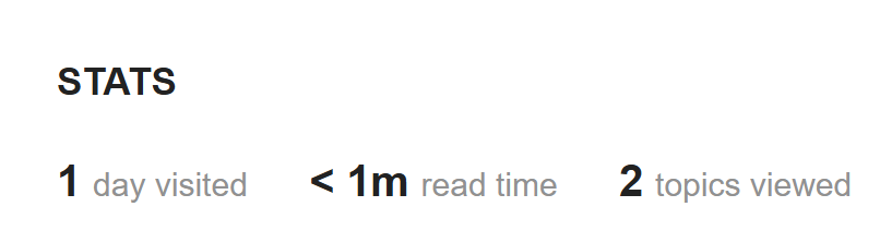

Looks like the OP is no longer interested . . .
I suggest this thread (which is going well off topic) is closed soon.
Was last seen 1 min. ago, so is still reading comments. Better leave this open for a while longer.
