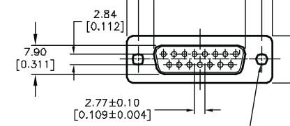

Edit: Apparently this datasheet is a bit of an exception. But without searching very hard I also found a connector from multicomp with the same 2.77mm pitch for a 15 pin D-Sub socket.

This footprint: DSUB-15_Male_Horizontal_P2.77x2.54mm_EdgePinOffset9.40mm has a links in it’s description to: https://docs.rs-online.com/02d6/0900766b81585df2.pdf and that also states a 2.77mm pitch.

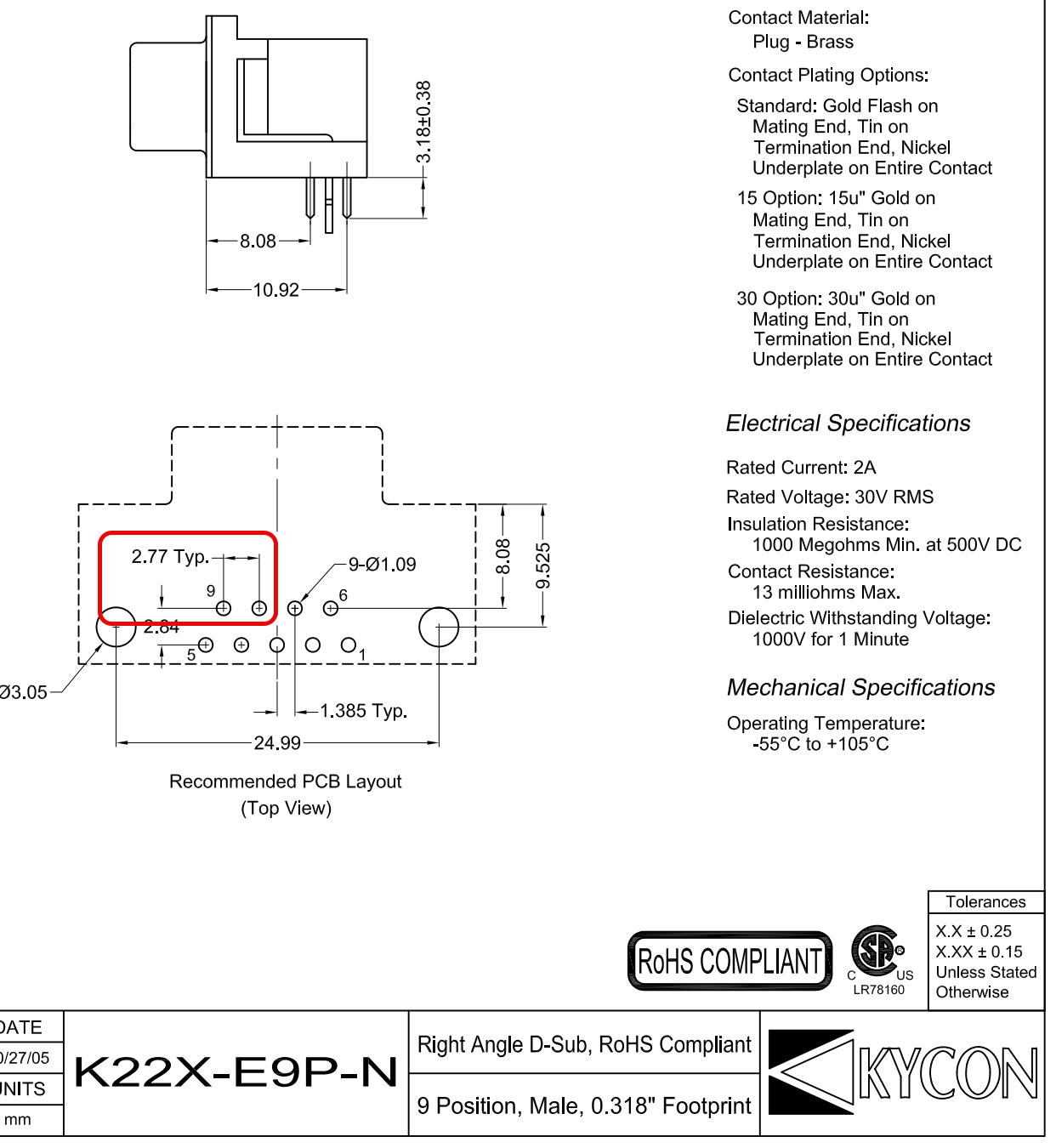

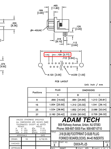

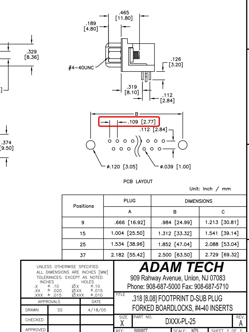

I have specs from three connector vendors. One has pins spaced at 2.74mm and two have them at 2.77mm. It is possible that the TRUE SPEC says 2.74mm, but when I buy an ‘ADAM TECH DE09-PL-25’ from DigiKey (DKPN: 2057-DE09-PL-25-ND) the pins are spaced at 2.77mm:
The same with a ‘KYCON K22X-E9P-N’ (DKPN: 2092-K22X-E9P-N-ND):
So, I use the D-SUB footprint with 2.77mm pin spacing.

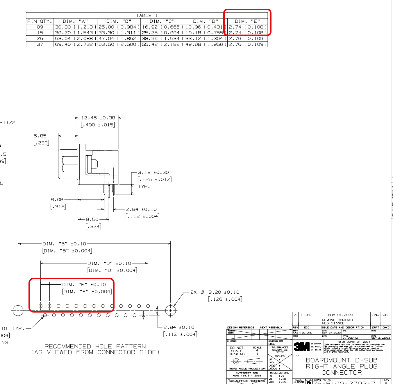

If I buy a similar 3M connector, ‘88609-5005‘ (DKPN: 19-88609-5005-ND):
I use a footprint with 2.74mm spacing (that I created).

But Adam Tech DA15-PD and Kycon K85X-AA-15P (straight solder cup) shows that they ignore the standard on the mating side. Simply don’t buy such connectors!
