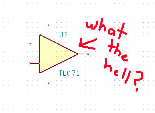

I’m making a component (TL071 opamp) in the Library Editor & saving it using these steps (as per Getting Started guide):
  1. Save Current Component To New Library - save "myLib.lib in “library” folder
  2. Preferences - Component Libraries - add “library” in “User defined search path” and “myLib.lib” in “Component library files”
  3. Select Working Library - Select Library - “myLib” - OK
  4. Update current component in current library
  5. Save current library to disk
Phew! Clunky or what? So, then I open Eeschema & go Preferences - Component Libraries - add path in “User defined search path” and file.lib in “Component library files”. Phew again!
I click “A” to place component, choose “myLib” and my custom component appears in the dialog box - cool!
But when I click to place it, I get the default TL071 from the built-in libraries, not my custom TL071 from “myLib” library!!??
What’s going on here & how do I fix it? It’s driving me nuts?! :tired_face:
Hehe…
KiCAD currently (it’s being worked on with the refurbishment of EEschema) omits symbols in successive libraries if they have the same name as a symbol in a library that’s already loaded.
So you got a ‘TL071’ in 2-3 libraries - the one in the first lib will be used.
To solve your problem either rearrange the order of libraries in the manager and bring your personal one up to the top (then the other symbols with same name will be omitted) or rename the symbol sufficiently that there is no other with it’s name.
OK ok so I discovered that Kicad doesn’t like duplicate names - even across different libraries…and deviously refrains from warning me lol.
