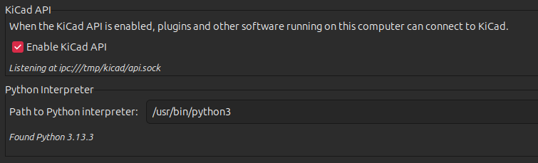

Anyway, I enabled the API and detected the interpreter as others have done:
when I try to run the hello.py example script I get the usual error:
$ ./hello.py
Traceback (most recent call last):
  File "/home/marcotrapanese/Scaricati/./hello.py", line 23, in <module>
    from kipy import KiCad
ModuleNotFoundError: No module named 'kipy'

do you have a requirements.txt? You have to put this line it it:
kicad-python >= 0.3

FYI, the API is not yet compatible with schematics, only with the PCB editor for now.
kicad-skip is a Python package for manipulating KiCad schematic and layout files.
Python is installed by default on all of the major Linux distros. It would be surprising to me if KiCad installed yet another Python interpreter on Linux, but I haven’t installed v9 yet.
You’re absolutely right, I was speaking from a windows point of view. That being said I read somewhere that snap packages ship their own python version
