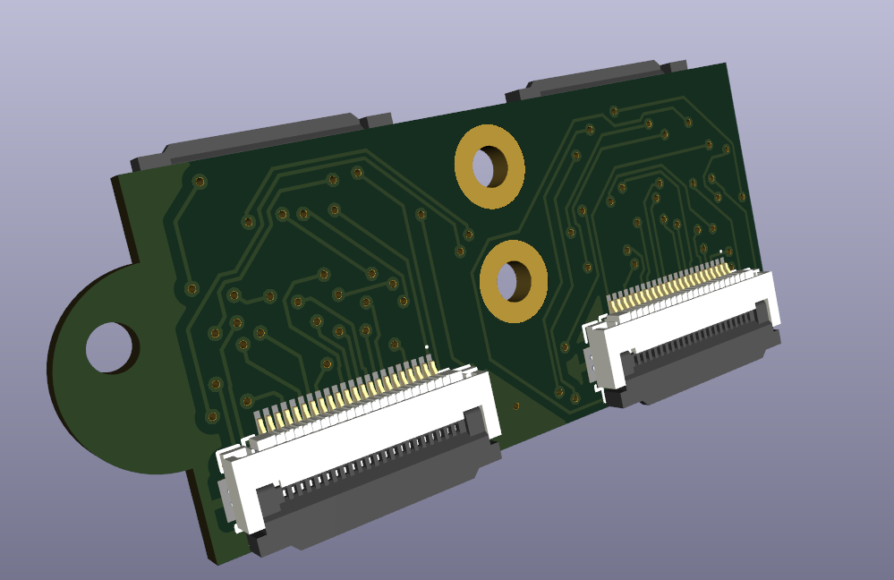

Where do I find this Mounting hole Pad in the footprints?
Hi guys,
So, pretty much all the mounting I’ve been using from the footprint is this one
which comes out like this
copper_pad
Like a copper fill or something because you can see the golden or copper pad.
But what I want is the one used on raspberry pi
which obviously looks like the holes on the board has been shaved in.
What’s the name of this footprint in the Footprint list ?? Or it’s not a footprint ??
I have browsed through the mounting holes and it’s probably there but when I use the 3D viewer
they all look the same thus it’s hard to tell.
Thanks,
I don’t know the meaning of the term “shaved in” regarding the mounting holes of the Pi, but isn’t the lighter colour just the base material, in other words, solder mask is removed?

If you choose the footprint right above the one you have chosen in the top screenshot, and then edit the footprint in order to increase the pad size to be larger than the hole, (right click on the blue hole → Properties → Diameter, under “Pad shape”) and set the copper layers to “None”, this will create the removal of the solder mask around the hole, shown in darker blue/purple.
There might be other ways or better ways, but this was the first one I happened to think about.
I think he means as if the copper has been shaved away, exposing the base material. He wants no solder mask and no copper.

I have followed your solution.
However, look at this image
You said that lighter colour is just the base material thus
I suppose the overlapping of the solder mask would obviously not cause any issues right ?
Also, this image
The back side mounting holes are dark colour, is this normal ?
I have applied the same mounting holes to the back side but unlike the front side, the colour is dark.

The lighter colour in the photograph of the Pi board is the base material, but with KiCad default colours in the 3D viewer the base material is the dark brown you see on the back side, and on the front side the yellow looks like there is still copper there.
Do you have the “Copper layers” set to “None” like in my screenshot above?
