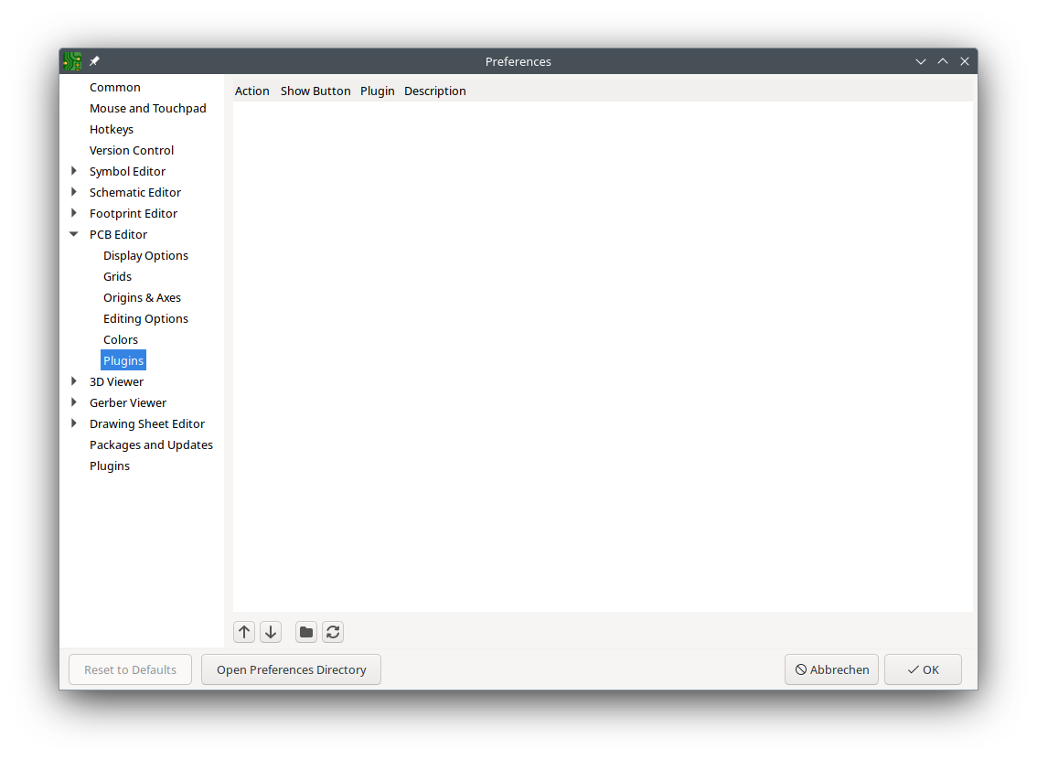

I’m running KiCAD V 9.0.6 released on an OpenSuse Linux system. All my plugins are gone. I’m sure that all plugins were there in V 9.0.4. Since that version I did not look at the plugin symbols because I did not need to use them.

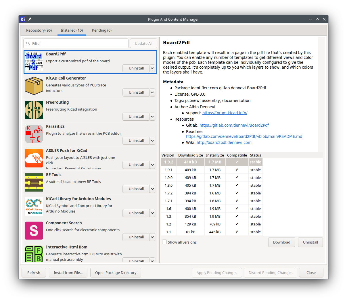

Since yesterday I realized that KiCAD was updated to version 9.0.6. If I look at the “Plugin and Content Manager” all plugins are there and the installed ones are marked as “installed”.
To try a quick solution for that problem, I unsinstalled e.g. the “Active ibom” and reinstalled it. No effect. It’s still missing.

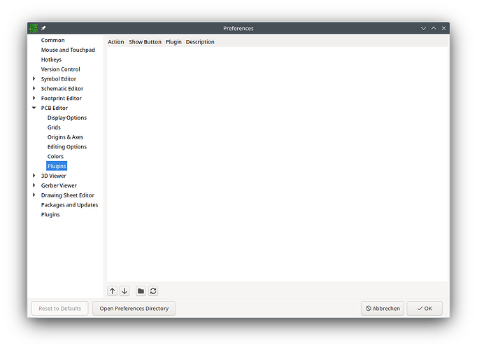

If I look into the preferences and there in “PCB Editor/Plugins” the window is empty.
What is my mistake? Is there a a function in preferences or somewhere else to activate?

Have you checked the following two places?
  1. Preferences dialog → Action plugins
  2. PCM(Plugin content manager)
“Open Package Directory” The folder name that can be opened with this operation and The exact location where your plugins are stored may vary.
In the case of Windows,
it may point to 9.0\3rdparty, but
the actual location may be 9.0\3rdparty\plugins.

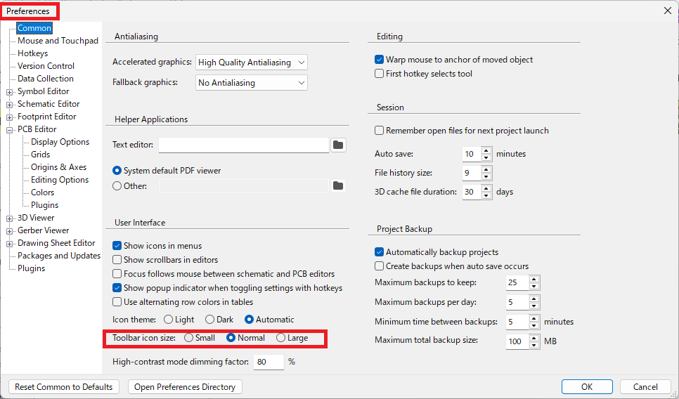

In a Windows environment, the solution I found was to reduce the toolbar icon size in “Common preferences” and then change it back to a different size, which would sometimes restore the icon. :slight_smile: (Small → OK,Normal→ OK)←- rebuild icon’s

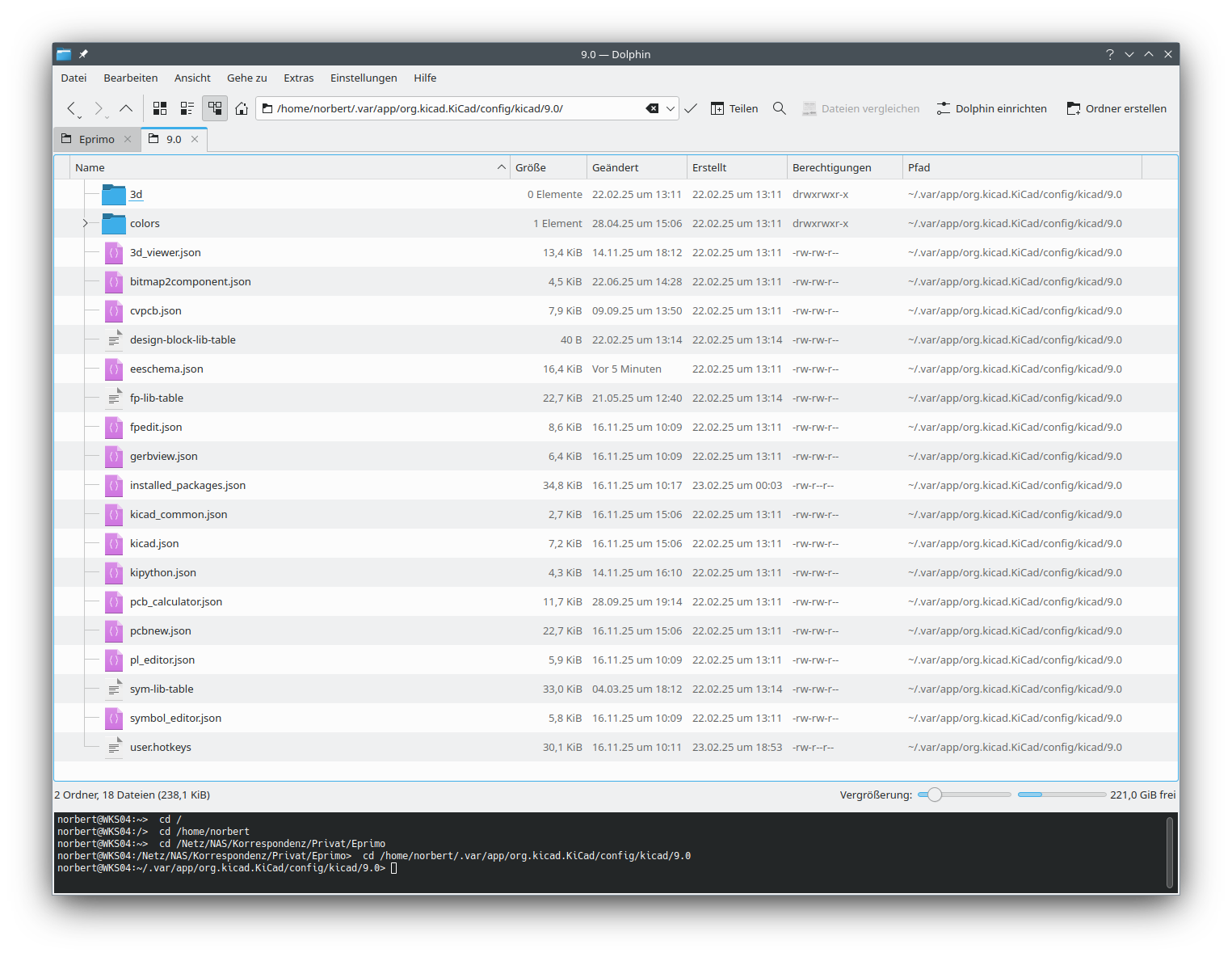

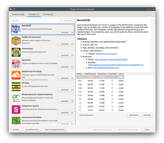

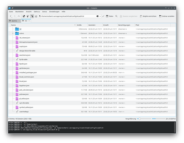

Hi tama,
here I have screenshots from different screens.
@tama: I also tried to install another plugin. Same result. It doesn’t show anything at the toolbar.

Flatpack installations currently have problems with plugins

You realise that native packages for 9.0.6 are available for openSUSE? See here:
However if you are running Leap 15.6 or older you may have to install a lot of dependencies. Personally I’m waiting until I have upgraded my workhorse to Leap 16.0 during the holiday lull before upgrading to KiCad 9.0.
I dislike container installs because of the issues they have around the edges.
