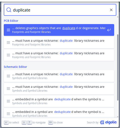

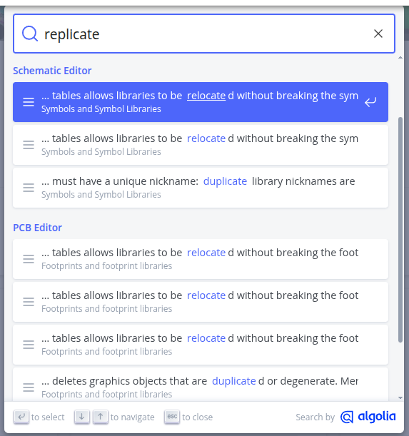

I apologize, but I’m not able to find anything related neither in the schematic nor in the pcb sections. Looking at the chapter titles I found nothing about replicating or duplicating parts of the PCB and even searching with those keywords seem not useful:
Perhaps is this operation properly called with a different name?
Thanks, I would never have guessed that they called it “multi-channel”! I’m reading it right now!
An unfortunate byproduct of a community plugin “Replicate layout” and native support “Multichannel”. It is fantastic that this is now built-in and extends the capability but there is enough web inertia refering to “replicate”. Hopefully the spiders find this post to assist in the association.
