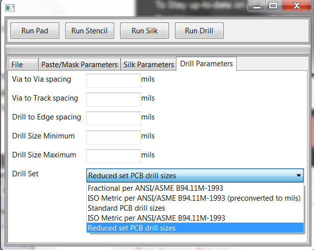

I have included drill sets within KiPadCheck, but I have not yet included a variety of algorithms that manufacturers might use to select the specific drill size from their set. Obviously, the manufacturer may specify something different, but the drill sets in KiPadCheck are:
I wouldn’t lose any sleep over trying to cover all possibilities. In the first place, if the PC board is fabricated by anybody living in the 21st century, you are buying the FINISHED hole size, which is a few mils smaller than the drill size that started the process. There are fairly accurate guidelines for how much smaller the finished hole will be, but it will vary from one vendor to another and depends on the details of their fabrication process.
As for the size mapping process, there seems to be two main algorithms. Some vendors fabricate the hole to the standard size that is nearest to your drawing’s requirement, while others sell you the next largest hole (if your requirement doesn’t match a standard size). About a dozen years ago I had a vendor who wouldn’t build my board until the hole sizes on my drawing matched his standard sizes - letting me decide whether a particular hole should be enlarged or reduced, if it wasn’t one of the standard sizes.
