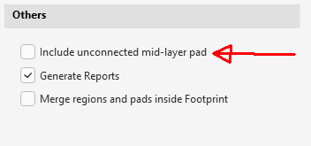

Top and bottom variations are my biggest need, but on the multilayer, need to have full control, as while I might have the top layer with big pad, and the bottom layer minimal pad, the inner layers in this case need to be defined. How are unconnected inner layer pads removed in Kicad at Gerber time ?
I could not see the option in Board_fabrication - gerbers - Plot.

Most software can remove unconnected pads on inner layers at Gerber export
In Altium, default is not plot unconnected pads
