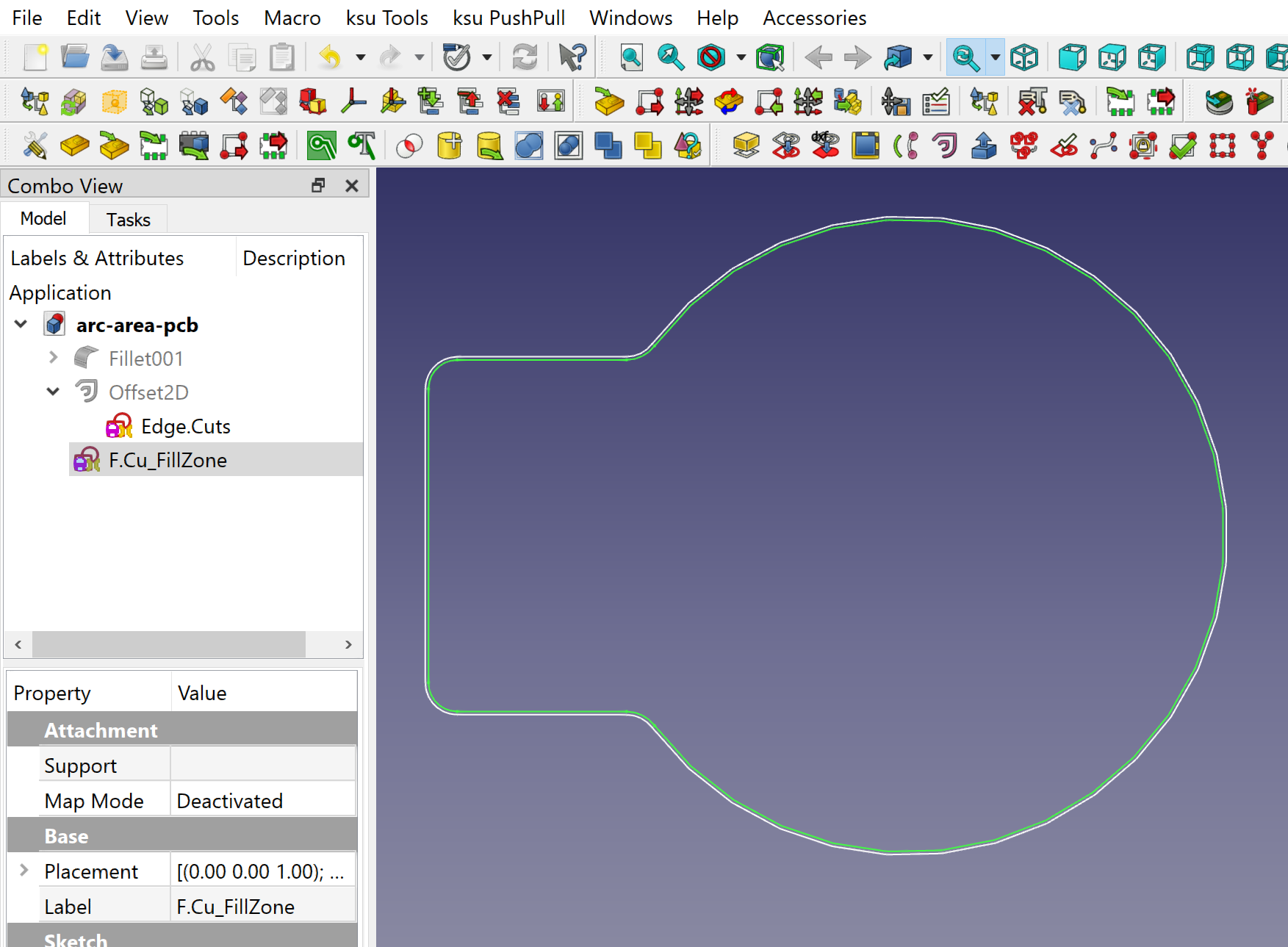

if you can consider a mecanical approach, kicad StepUp can push both Edgecuts and FillZones to a kicad_pcb file.
