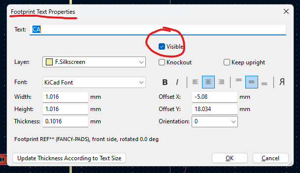

As for your question about hidden text, as of shortly after 9.0.0 release you can’t do hidden text in PCBs/footprints anymore, and some options about plotting invisible text were also removed. This is an intentional change. The reasoning is basically that PCBs represent physical objects and invisible text is inherently nonphysical. Invisible text was ignored in DRC and other functions, but could be plotted as if it wasn’t invisible, and therefore could result in boards that passed DRC to have shorts or other issues when manufactured.
If you’d like to hide text, you can hide the layer it’s on, move it to another layer, delete it, etc.
Edit: to be completely clear, since this has been linked a few times now, the above applies to footprint text, not footprint fields. Footprint fields can still be hidden, though apparently there is a bug in 9.0.1 that hides the checkbox in some dialogs. You can still show/hide fields (not text) using the Footprint Properties dialog and the Edit Text and Graphics dialog. When the bug is fixed (9.0.2?) you’ll also be able to hide them using the properties panel and the properties dialog for the field.

It is still gone in 9.0.1 RC2. Then it must be on purpose…
The only texts that I usually set to invisible are the component values on the fabrication layer, as they usually take up too much room. I can still set them to invisible in the component properties but not in the text properties. So it makes no sense to me…
I was about to post about the same problem, not only in the footprint editor but also in the pcb editor, I have some copper areas as footprint that do not need a reference and it really took me a while to find out how to make them invisible from the silkscreen:
Selecting the text and hitting ‘e’, nop:
Clicking on the footprint and hitting ‘e’, nop:
Long clicking on the footprint, selecting footprint and hitting ‘e’, on the properties of the footprint dialog, but not on the properties side panel:
I very much would like to be able to click on the text and hide as before, being unable to create footprints with hidden text can stay if it has cause problems already, but I like being able to quickly remove unwanted stuff

To simply hide text you can select it an hit delete.
Looks like the issue was fixed in version 9.0.2
I have the 9.0.2 D/L and it is missing in my windows win11 version. I really need it to be able to hide all text capability on anything I want to hide. It is just good practice. Don’t allow printing hidden text, it is hidden for a reason. Don’t take flexibility away from the designer, and make the designer keep up with his hidden text. Unless the text is on the wrong layer (copper) it can’t short the traces.
as a workaround for now you can just hit delete after selecting. Deleting it is the same as hiding it.
