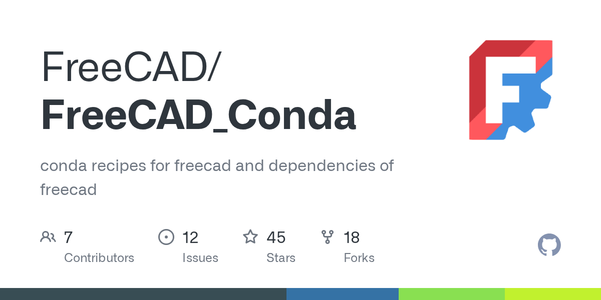

At the same time another person to contact is “realthunder” @Zheng
He is the guy who generated the scripts for FreeCAD’s AppImages that run on different versions of Linux. At FreeCAD they are using Conda
Conda should be the key in AppImage building:
Conda gives the opportunity to distribute FreeCAD in a consistent way for multiple platforms. This is the biggest advantage of conda: A package-manager which works in the same way for different platforms.
Hoping you or your team will be able to give KiCAD an AppImage option that will help users to use different releases on the same platform.
