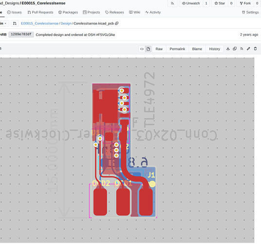

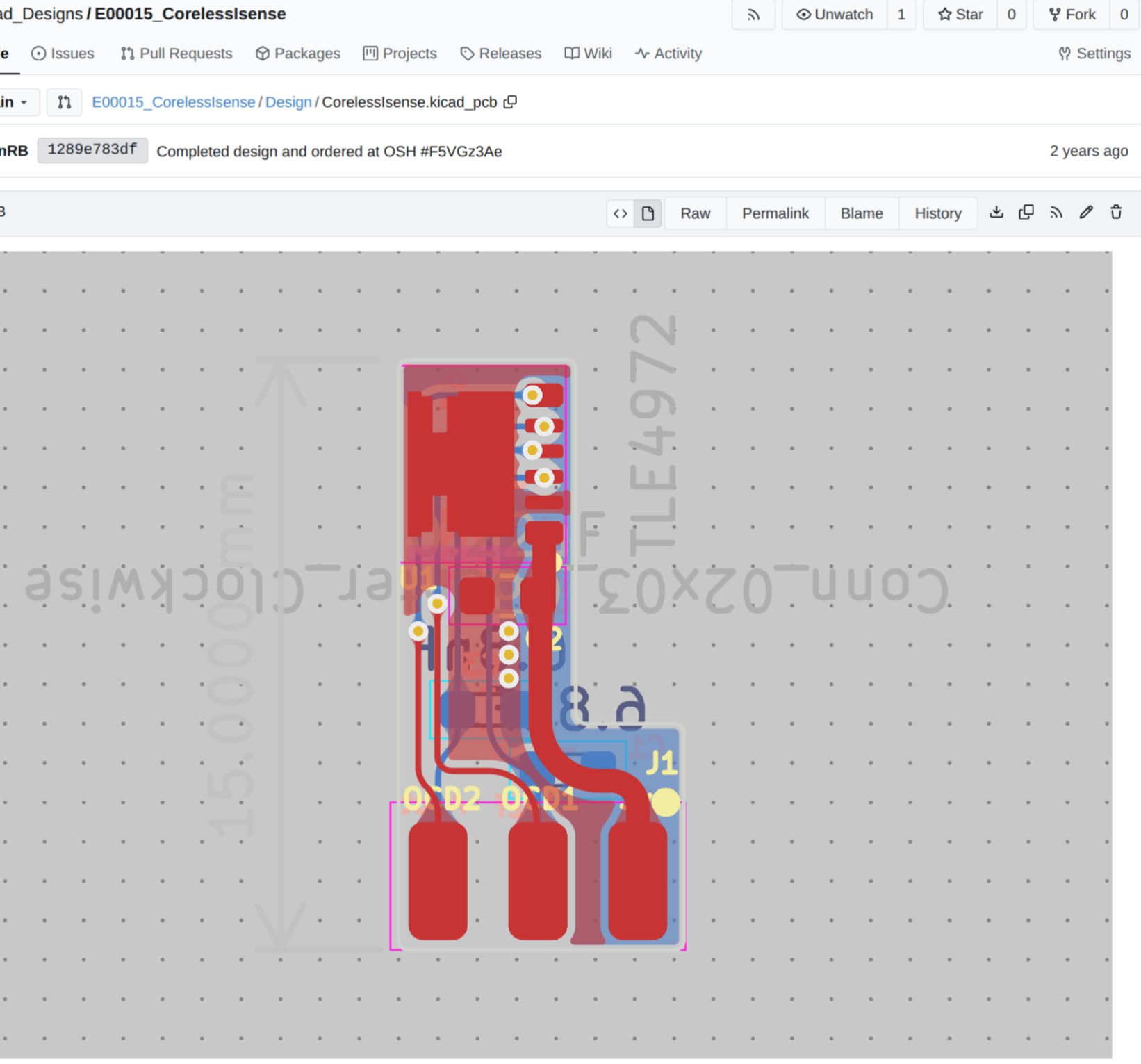

Thats what I am using. I have it integrated with my personal gitea instance for version control of my designs.
