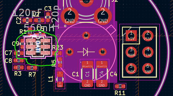

Dear Team,
How do I see ratnets specific to a component.
Below is the board file with ratnets off.
What I would like to see is when I click on the component (Highlighted in Green),I need to see only the ratnets connected to that component.
This will make my routing easy.
May I know how to do that.
Regards
HARI
You can use the local ratsnest tool or the nets panel.
Disable the ratsnest view (image) in the left toolbar, then use the local ratsnest tool (image) in the righthand toolbar to turn the ratsnests for a certain component or pad on or off again.
Or use the nets tab in the appearance panel (top right) to select nets to show ratsnest lines for nets by name:
