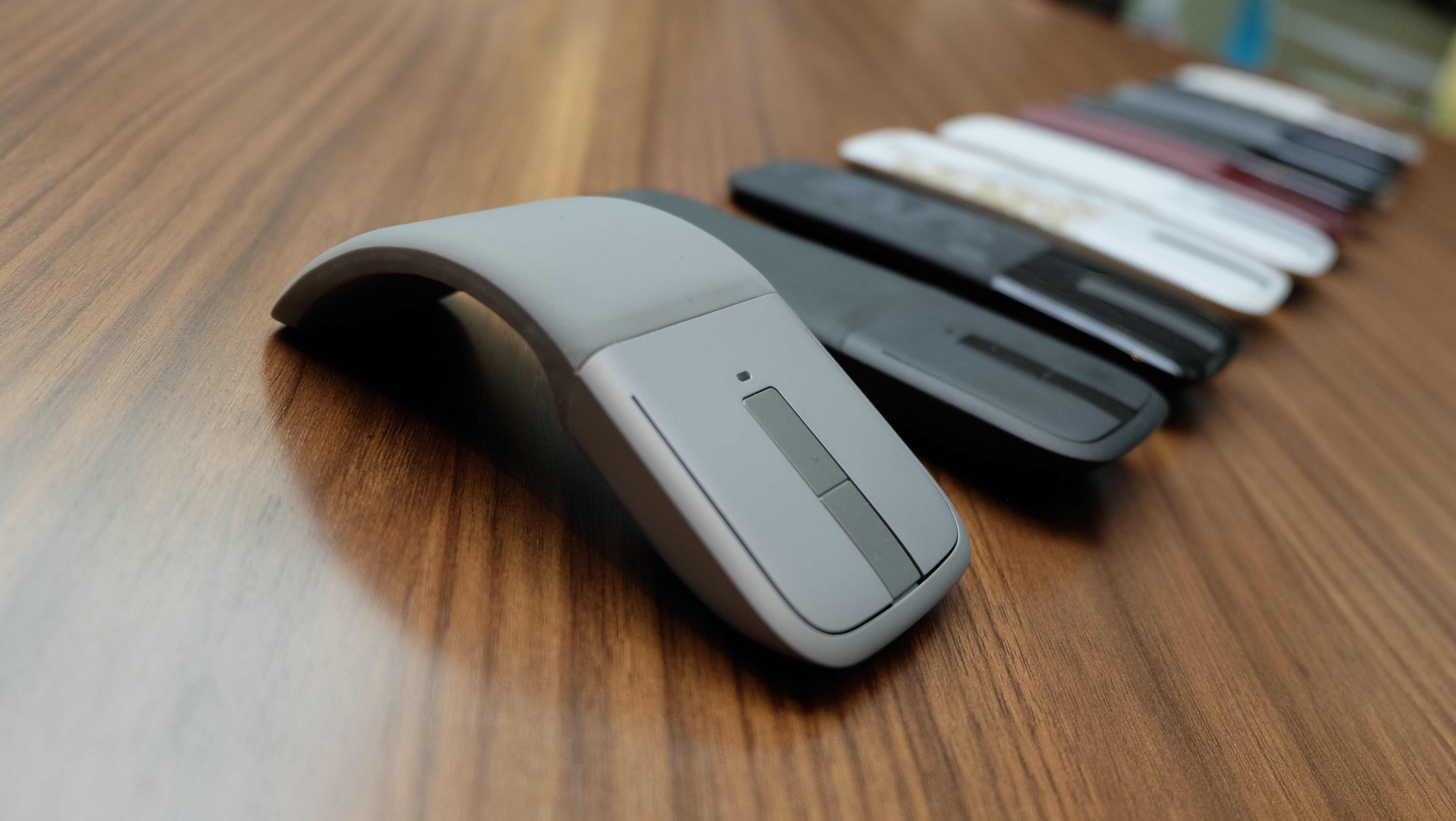

I had the same annoying prob in windows…
I switched to Arc Touch Mouse
it has not a wheel but a touch surface, so it is easier to handle zooming and panning
or a trick is to move the mouse where you want to pan and press F1 or F2 to zoom…
that will zoom and pan where the pointer is…

one tap on surface and you pan, then you can swipe your finger to zoom in and out
moreover in general, if you move your mouse to a new position and then you zoom, pcbnew auto pan on that position, zooming exactly on your mouse new position… :slight_smile:
