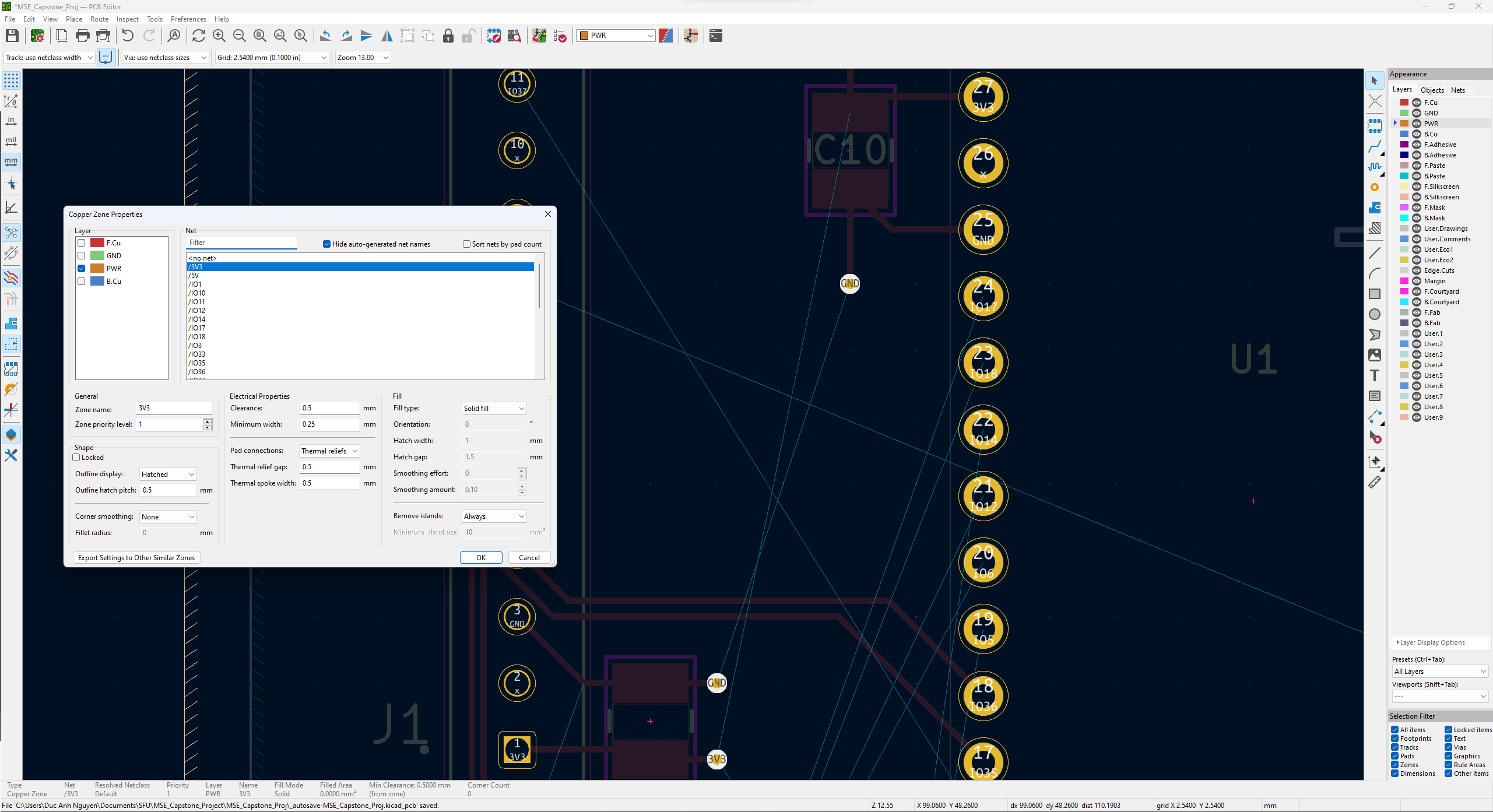

I have been getting used to designing a PCB with KICAD which involves multiple layers design. Currently, I am designing a board with 4 layers, and I have a question regarding the power plane and VIAs.
I would like to power a 3V3 plan from a power source (battery) placed on the top surface, and I do acknowledge that I have to use a VIA to create a connection from the top surface to the inner power plane. My question is, is it fine that I just place a through-hole VIA from the top surface to the bottom surface, or only place a VIA from the top surface to the inner power plane? Will the through-hole VIA would function correctly (supply power to the 3V3 plane) as long as I assign a net label of 3V3 (my label for 3V3 pins) to the VIA?

I have tried to put through-hole vias on the top surface to connect it to the power plane. However, what makes me concerned is even after I set the layer net (by creating a zone and assigning a net to that zone on the inner layer), there is still a rat nest connection between vias and pads. I just wonder is it a normal thing? Below is the a capture of the layout.

There is a limit to what I can tell from your uploaded image. But
notice that the vias (not just the planes) are assigned to nets. Be sure that all of your individual vias are assigned to the proper nets. Look for the properties of these vias (and then the net) that the rats nest seems to be connecting wrongly. (And check all of your vias.)

Thank you for your reply. Regarding the image that I have shown above, I have already set the net of the vias the same as the net of the power plane. However, there are still rat nest connections that appear for some of the vias, which brought up the concern.
My ultimate goal is to power the power plane (3V3) with a microcontroller pin, and other peripherals on the board would be supplied by that plane. The same idea to the ground, with the final goal of making sure every component is connected to the same ground plane. Would you mind sharing with me a good approach to achieving such goals?

Here are some other images that I have set the power planes to the same net as the vias as well, and the rat nest still appeared.
I think I know the problem. I have not filled the solid to the power plane. After I filled all the zones, the rat nest from the via disappeared. Does that mean that everything is good now?

The tracks to C10 are still not wide enough by a margin. The vias @C10 are 1, too far away from the component and 2, unnecessary, because the connection is made at the IC pads. Or - the other way round - the tracks are redundant provided you move the vias close to C10 and C10 closer to the pads.
Anyways should C10 be closer to the pads.
That basically goes for C13 as well.

But then, I would leave the pads connected and get rid of the vias, move C10 closer to the pads and have at least 16 mils (0.016") tracks to connect it.
