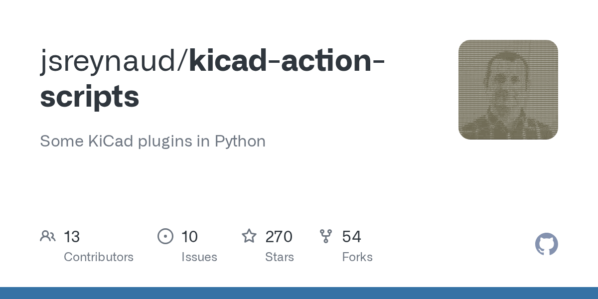

I installed the “Via stitching” plugin from GitHub - jsreynaud/kicad-action-scripts: Some KiCad plugins in Python
I was impressed by how easy it is to use and its potential to simplify the time-consuming task of placing stitching vias!
However there seem to be some issues … and I am wondering if there are any workarounds?
