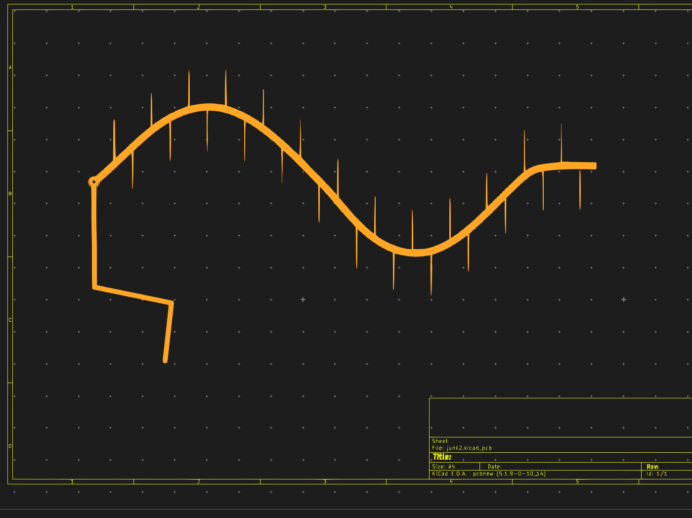

I want to draw complex geometries in copper on my board using (I guess?) a large number of traces / copper zones. In this case I may have hundreds of copper traces whose length I would like to easily design / control / edit.
So far I’ve been looking at importing dxf drawings (which don’t seem to be able to import to copper zones), as well as scripting the geometry with pcbnew. I haven’t got anything really working yet, and would still love to hear suggestions on the best approach.
Instead of expecting everyone to Guess and Imagine what you want from what may be your poorly worded explanation, why not post a simple sketch of what you want… you can do all sorts of custom pads…
Lets say I want this structure in copper on every layer of a multi-layer board. Where the short thin traces are all a quarter wave long. And I’d like 5 boards for 5 different frequencies I’m interested in.
Determine the line lengths, curve, widths and placements…etc
Several Options to draw it:
• You can Draw directly in Kicad
• Draw image (jpeg or bmp) in external graphics program and use Kicad’s BitMap Graphics tool. It exports a .mod footprint
• Draw in a CAD or other graphics program save as DXF and load into Kicad, change layers
After getting a footprint .mod file, you can Edit it (it’s text file) and change the layer to desired layer. Meaning, locate the Layer tags and change them as desired.
Example - using the Bitmap Tool- sequence shown in images below:
• I used a Screenshot of your sketch in the Bitmap Tool. Saved to Eco layer (saved screenshot.mod footprint)
• Loaded the .mod footprint into PCBnew
• Select it and Edit the Library footprint
Double-click and Change Layer from Eco to desired layer. Example shows change to Bottom Cu.
•Then, update the footprint or place a new one…
You can Edit the .mod file and change the layer, as I said. Including change from Dwg/Silk/Margin… to Inner and Outer layers…
The example below shows edit of the above file to change to inner layer “In1.Cu”
I’ll leave it for you to explore… I did Not do a Clean-up on the graphic, only changed layers to show how to do it… Includes the verification that it’s moved into In1.Cu

Step 4: You can now the draw the curved track as shown below.
To define the track width follow the steps shown in the below screenshots. (Right click >Select Track/Via Width > Use Custom values)
To draw the vertical lines please follow the below steps:
Step 1: Select the option “Draw a line”
Step 2: Select the board setup option to define the track width (It is set to 2 mils in the below screenshot)
This option also displays the length of the track. It helps you to have a uniform track length for all the horizontal tracks.
