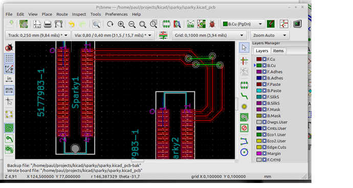

So I took your rar file, did a “sudo apt install rar unrar” to be able to open it and then I made a little project out of it:
KiCad / File / New / Project / "sparky"
Extract rar file from: "Val**" text will not go away in project directory.
KiCad / Preferences / Manage Symbol Libraries / Project Specific Libraries / Add: /home/paul/projects/kicad/sparky/2020-09-23_12-36-00.lib
KiCad / Preferences / Manage Footprint Libraries / Project Specific Libraries Add: Footprints.pretty.
Eeschema / a / 2020-09-23…
Draw wire, [Insert] to multiply.
Annotate.
[F8] Hmmm, Footprint not recognized.
Eeschema / Hover over connector / f
Footprint Name is:
CONN_5177983-1_TYC
**[Select] ** (Opens footprint browser) Look at “footprints” library.
It has one footprint, whit name: 5177983-1. Accepted that footprint with double click, and [OK] to close “Edit Footprint Field”
Copied the Footprint text (inclusive library name) to the other connector.
Routed 3 tracks.
Result:
Can you follow me to here?
Is there anything you do differently upto here?
Next step for you is to take this attached project, reproduce your fault and report back step by step what you did, pay extra attention to differences to what I did and what you do.
Do you know that Pcbnew makes copies of the footprint from the library, and that if you change a footprint in Pcbnew( with [Ctrl + e] to load it in the Footprint Editor, then you only change the copy on the PCB. Not the library itself. This is one of the things that could have gone wrong with your workflow.

I’m confused by what you say and what the attached footprint in that archive is. I don’t see any problem there. There’s no any text on several layers. The value text is only in the front silk. I’m trying with 5.1.6 and 5.99.
