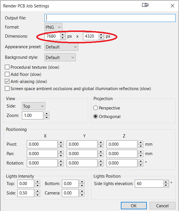

I see the Render function via the V9 Jobset functionality has an option to set the bitmap render resolution. I find this useful esp for larger boards as I can create images that have a higher resolution than my monitor. I can create 4K images even though I only have a 2K monitor. This way one can zoom in and preserve details.
However, I can’t figure out how make the Jobset Render function control things like excluding DNPs and layers like User.Drawings etc like I can with the 3D Viewer Appearance Pane, and I can’t figure out how to make the 3D viewer export a rendering at higher rez than my monitor happens to be.
Is there a way I can make KiCad export a render at high-rez and exclude things like DNPs and specific layers? The best of both functionalities?

You could try to use the appearance preset field:
  • open 3D viewer, check/uncheck the wanted options in the right side apperance panel
  • save these settings as 3D-viewer preset
  • use these saved preset in the jobset render dialog (below the red circle in your picture)
Thank You! For anyone else, it seems the Appearance Present entry in the JobSet Render setting is new to 9.0.4. I had tried 9.0.4 RC1 from home and when I tried it at work today with 9.0.3, that entry wasn’t there. Coincidentally, 9.0.4 hit release status today and your solution worked a treat once I upgraded.
