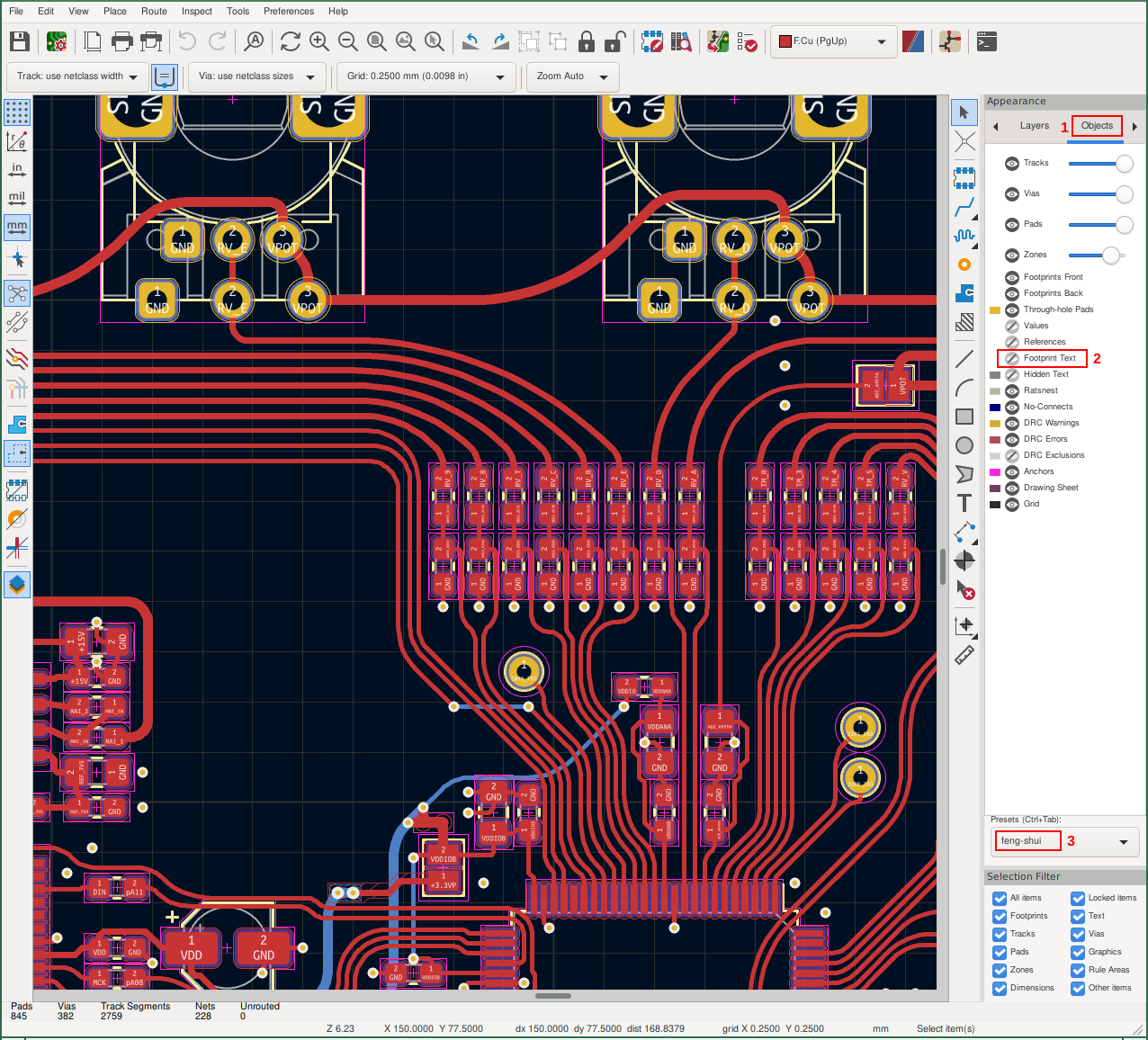

this is what i do:
when the board is “young” there will be a lot of rapid footprint moving around, track routing, flipping… etc… i call this process “feng-shui” so i make a preset for it:
basically turn off the “Footprint Text” there and save this as a preset
when the board is nearly done (footprints in place, tracks routed, etc…) it’s time to feng-shui the RefDes and the values on the Fab layer
for that i use a different scheme:
Refdes: turn off the Cu and Fab layers, keep the pads/vias visible, select the relevant SilkScreen layer and go to high-contrast (H) mode, if it’s the back-side - also use the “mirror” view
Fab: just go to high-contrast (H) mode on the Fab layer
and unfortunately, these wonderful presets happen to be saved in the project
i thought they are global
