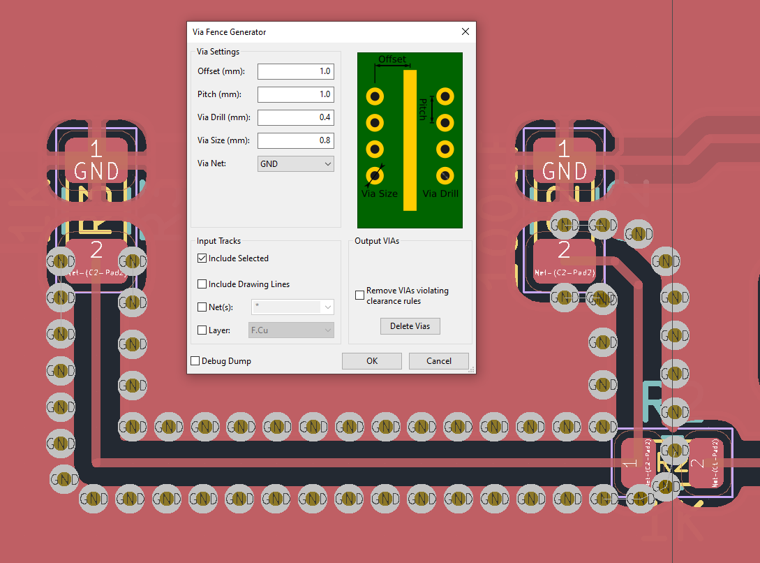

Using Via Fencing plugin
I am using 5.1.8 on Windows
I have made a trivial design with one net between two resistors and GND, double sided board.
I have tried pacing planes on both sides, but just cannot get any vias placed

Via stitching works and gives similar results to your screenshot.
Via Fencing is a different function and the result is supposed to look like this

I gave it try and i got it to work by deselecting the “Remove VIAS violating clearence rules”

After a bit more experimentation, the default values for Offset and Pitch do not work correctly on my test project, changing them works also:
it works on my side.. have you assigned the fill zones to GND (or whatever net you need)?
If you upload the board, it would be easier to investigate.
Working, @der.ule gave me the clue, the default via size requires 1.3/1.3 offset and pitch
The plugin defaults could do with a tweak, especially as nothing is remembered every time you run the plugin
