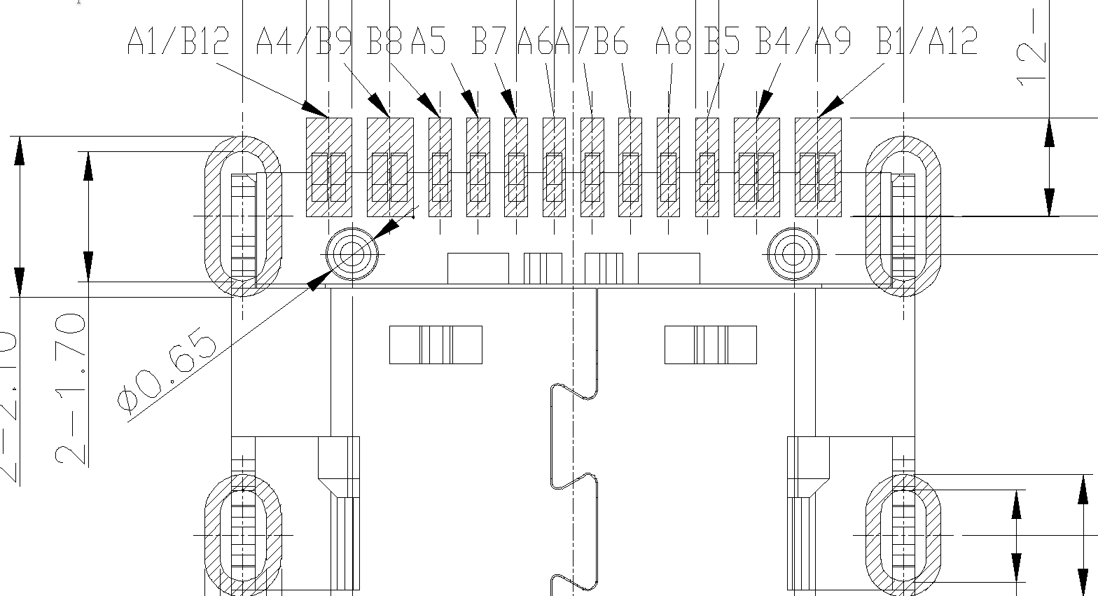

Hi, I am trying to build a PCB with USB typeC connector and I am going to use this: HC-TYPE-C-16P-01A | HCTL | Price | In Stock | LCSC Electronics .In the KiCad there is a footprint called: Connector_USB:USB_C_Receptacle_HCTL_HC-TYPE-C-16P-01A which I believe it should be the correct one but in the PCB Editor it has multiple pins for same connection as in the picture below ;
For example the first two pins (A12-B9) and last two pins (A9-A12) have multiple pins when I click on them it shows two different pins as in the screenshot. Is this normal? Also should I connect pins B9 and A9 (5V pins) in the PCB editor as well or they both supply 5V separately ? Also for the two different D+D- should I connect them or they are already connected?
Yes, this is quite normal.
With USB-C connectors, the pins have specific names (A1 through A12 and B1 though B12) and these have specific defined meanings. Because the connector is reversible, it’s also symmetric and with quite a lot of double or even quadrupled pins.
The connector fabricator knows this of course, and not all pins in the connector have separate pads on the PCB, and multiple pins end up on the same pad.
The footprint is indeed odd. It seems to be laid out so you can mount the connector on either side of the PCB.

Sorry, I could not resist! Albeit I understood what you wanted to say. It’s a property of USB-C, the plug is reversible. And it is easier to make the connections on the PCB.

The page you link too has the recommended layout in the data sheet.
IF you blow it up large enough you will see this starting to make sense. I think…
Do I need to connect them in the PCB editor as well ? Especially for the duplicate 5V and duplicate D+ D-. Or they are internally connected without routing?
What you mean by impedance and length matching ?

This is clear, I know what USB-C is, thank you very much . But it’s the first time I’ve seen a PCB footprint like this, and honestly, I think it causes more problems than simply having two footprints: top and bottom.
