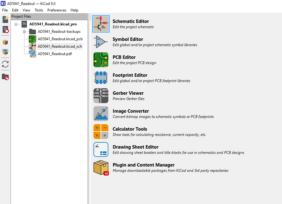

Below is my Project window:

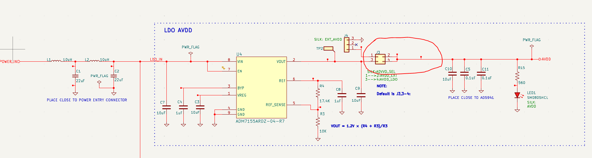

Schematic section:

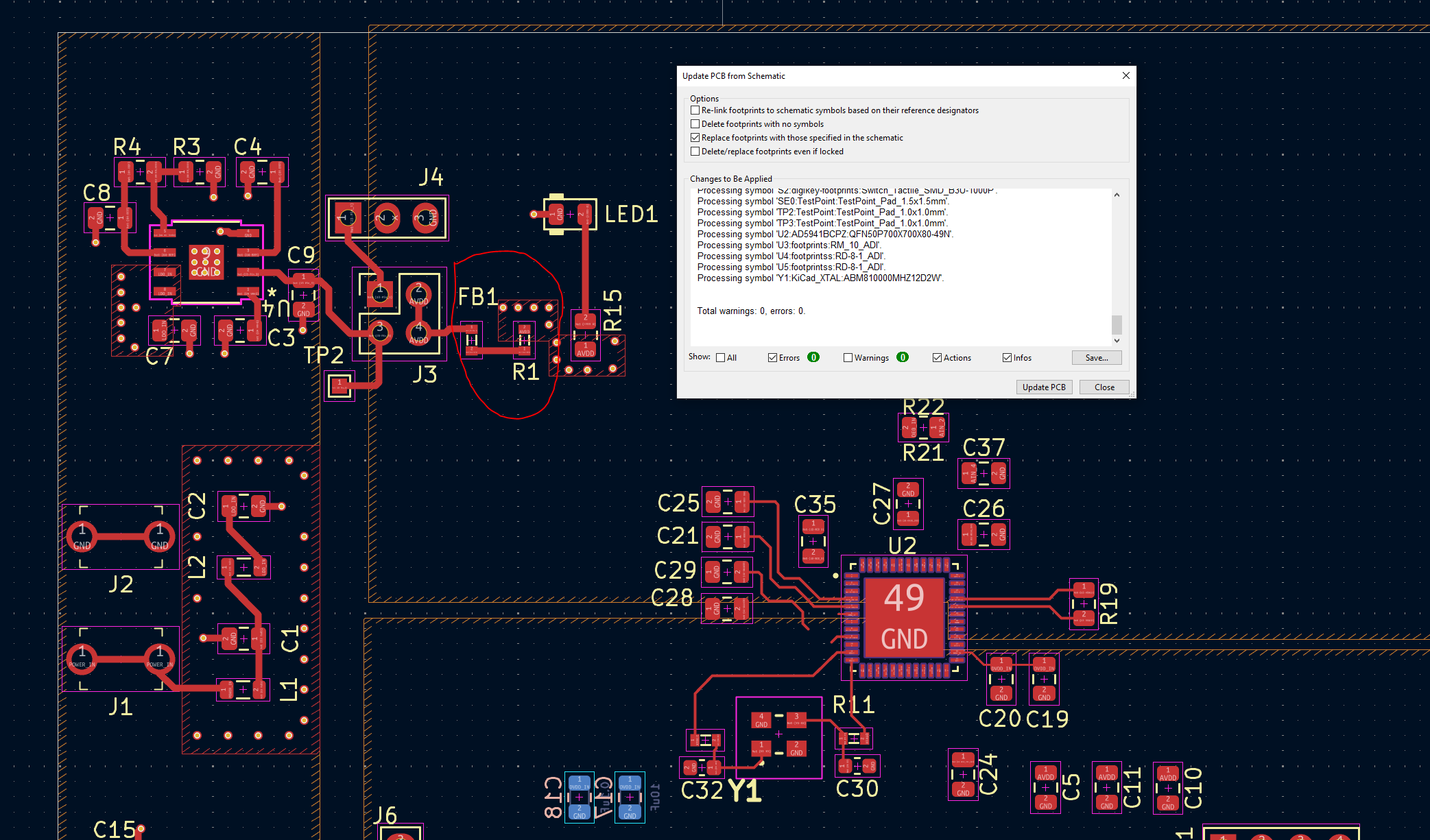

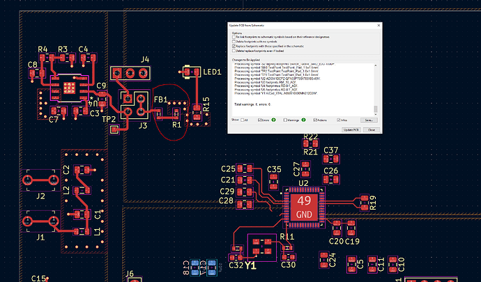

In this schematic after J3 initially I put a ferrite bead and a series resistor.I removed that ferrite bead and series resistor.Went to layout run update pcb from schematic.But the layout still contains Ferrite bead and resistor.
You have to enable “Delete footprints with no symbols” to achieve what you want
