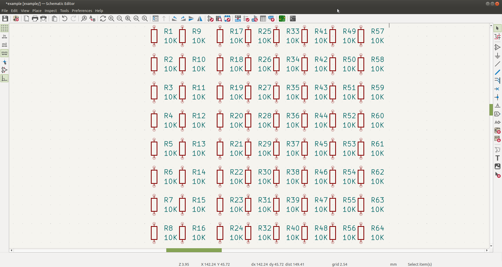

An example:
Overly simple schematic
This is what I get in PCBNEW
I would be happy with just this when updating PCB
This would be the best I could ever ask for, sorted and not overlaping

  • after schematic–>board you have the “pile of footprints” like in your above picture
  • draw a rectangle board-outline next to the footprint-pile (must be big enough) (not necessary the final board-outline)
  • select some (or all) of the footprint-pile
  • execute: main menubar → Place → Autoplace Footprints → Place selected footprints
Maybe you like the result. You can also delete the board-outline after autoplacement
It’s not sorted but at least now the footprints are not overlapping.
