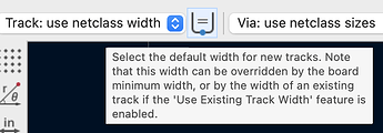

What is your definition of “my default trace width”?
The usual workflow is to set up a few net classes, and use the parameters of those net classes for the tracks.
I also had a look at: PCB Editor / Preferences / Hotkeys and did a search for track.
There is a Change Track Width, that does not have a default key, but from it’s descripton it only works on a selection.
Also, when you have a few tracks selected, the u key expands the selection to select more track segments of the already selected nets. There are some other ways too to help with selection. And once you have a selection of (only) tracks, then you can press e to edit their properties, and that menu also has several options for changing the with of the selected tracks.
The only option I know to change the width of all tracks (without selecting them first) is with PCB Editor / Edit Track and Via Properties
Well I thought I had set Board Setup/ design rules / netclasses, Default to a track width of 0.2mm (because I have 300 coonnector-pads on my board that require 0.2mm or smaller tracks. But when i look there now, it is still set to the program default of 0.25mm.
The only place I’ve found 0.2mm in my setup in design rules / Pre-defined sizes.
It is one of the track widths that I can quickly select on the fly with keyboard shortcuts W and shift-W. I wonder if I hit some keyboard shortcut by accident. Or if my cat walked on my keyboard again…
These screenshots may help
Click to setup the widths…
Hover the mouse for this info…
Set the widths
