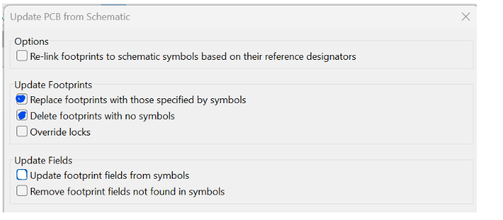

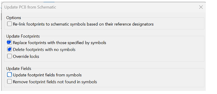

I am working on a PCB and it is mostly laid out but i needed to add some extra circuitry. I use the re-annotate entire schematic function however when i update PCB it adds completely new parts rather than change the designators of the old existing ones.
How can I get this so only reference designators are updated?
I have also tried with the first option ticked however as soon as I annotate i get completely new parts added

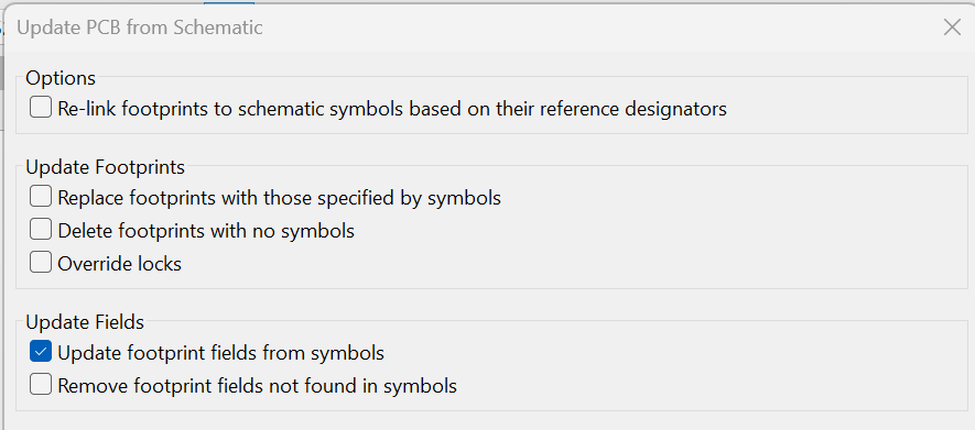

I think this should work . . . make sure you have your project backed up just in case.
Ah Thanks, it worked
I wonder what happened. It always (V5…V8) worked after changing designators at schematic.
