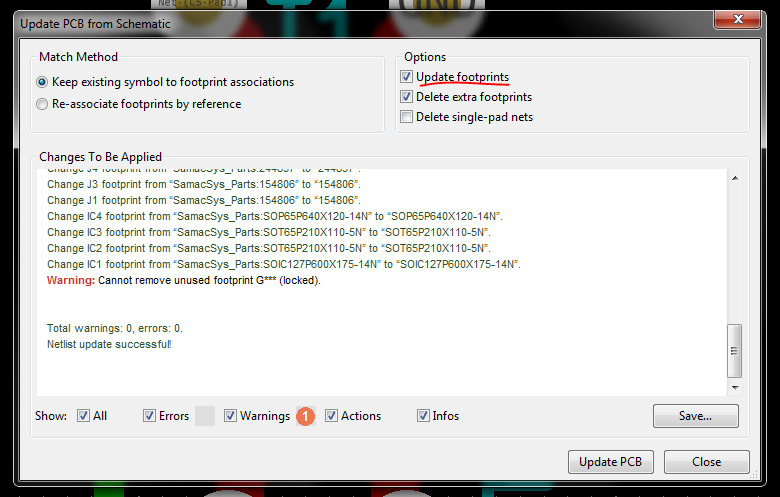

Stepping through the steps:
Before the update from the schematic:
As you can see I have moved the value on the F.SilkS layer and the reference on the F.Fab layer. Both text were resized. The T1 above the footprint is just text.
Since I am not allowed to share all pictures in one reply I had to split up.
Now I update the PCB with no changes made to the schematic - especially no changes to the associations of the symbols to footprints.
After confirming the update with “Update PCB” the text items were moved back to their original layer, resized to their original height and the visibility of the value text got disabled.
As said - this problem only affects some footprints. Others will not have their text items reset.
The dialog message says that there has been some change. Maybe your library setup has changed? For example SamacSys_Parts:SOIC… -> SOIC…
Those footprint identificators are different, handled as two different footprints.
Indeed - I didn’t pay attention to the changes…
Seems like the problem results from LibraryLoader setting the symbol properties incorrectly.
As can be seen in the symbol properties in Eeschema the Footprint reference is “SOT65P210X110-5N”.
When updating in pcbnew from the schematic, the footprint gets the library reference “SamacSys_Parts:SOT65P210X110-5N”. Upon the next update pcbnew only sees the difference and reloads the footprint.
Changing the symbol property Footprint to “SamacSys_Parts:SOT65P210X110-5N” prevents the reload of the footprint and thus the reset of the text items.
