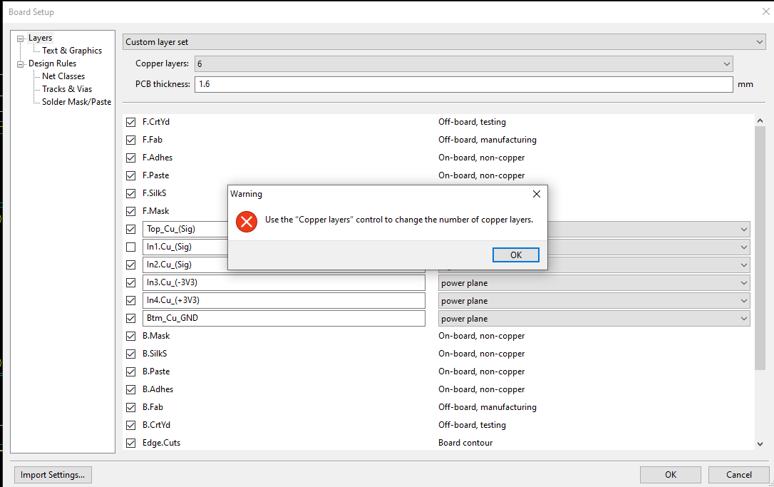

Can somebody help me with this please. I have designed a board with 6-layers as I thought that was what I would need. In fact I completed it with 4 layers. So, what I am trying to do is to simply remove the unused copper layers but KiCad appears not to be giving me the option of which layer I should remove. It seems it wants to just remove any two layers and I am concerned that it will remove the wrong layers.
I thought I could just untick the layer that I don’t want but I get the following message instead:
If try what Kicad suggest, I get the following message:
Frightening as I don’t know which copper layer it will remove.
Is there a safe way that this can be done?
Many thanks.
Sorry I should have mentioned that I’m using Kicad 5.1.7. Before I get told off, it’s not my choice. My paying customer insists I use that version and would not be persuaded any other way!
I don’t know . . . but logically it would remove In3 & In4 so if you ensure that your inner layers in use are In1 and In2 you should be OK.
Do a full backup, or two just to be safe and give it a go.
Actually, I have used In3 and In4. Free layers are In1 and In2.
Many thanks @RaptorUK . Sorted. As expected, it deleted my used In3 and In4. However, fortunately these are just power planes of the same shape as my ground plane on Btm_Cu. So I just copied the polygon to In1 and In2 and rename the nets. Voila! All is well.
