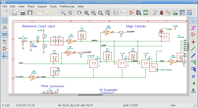

Before I opened the project I noticed that …-cache.lib is not present.
I do not know if this is intentional, but this is a very important file in KiCad, and you should always back it up with your project. Because that file is missing the schematic looks like the screenshot below on my system.

OK, then I’ll assume for now that the upgrade will fix it.
