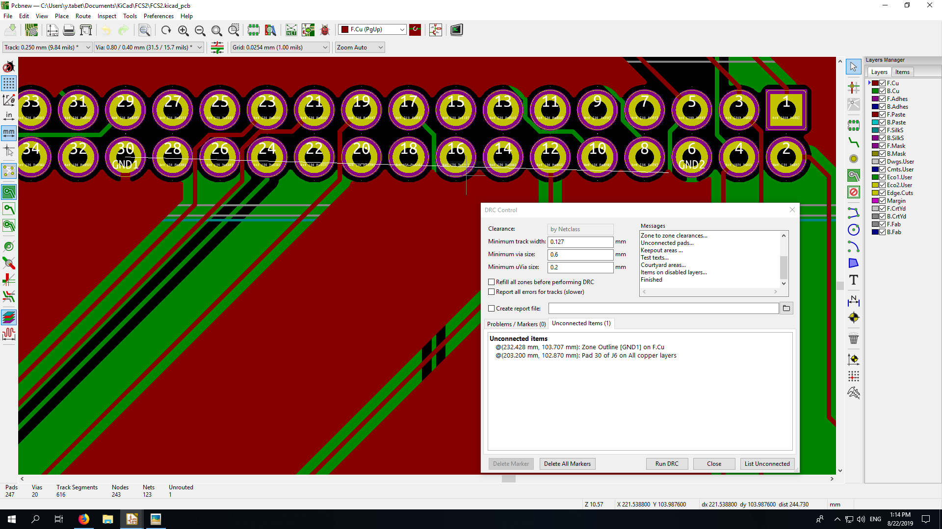

Hello all,
I have poured copper on both F.Cu which is GND1 and B.Cu which is GND2 …but i got the following unconnected item when runing DRC…!!?
unconnected items:
@Zone outline [GND1] on F.Cu
@Pad 30 of J6 on all copper layers
I tryed changing GND1 and 2 to other pins without any success.
any suggestions!?
Regards,
You gave little information.
From this view, GND1 on the left (connected to pin 30) is isolated from GND1 on the right. (around pins 10 and 8). The zone must be continuous, the zone on the right is an island not connected to other GND1 signals.
Maybe try to refresh the zone with B and Ctrl-B ? could be that you added a track after pouring the zone.
