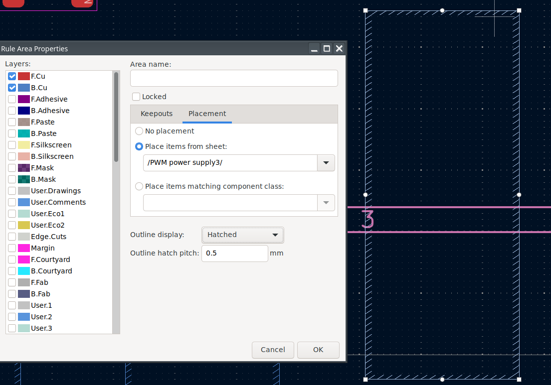

I copy and pasted just the rule area rectangle to a new location on the PCB and set its properties as follows:
Then I did “Tools → Multi-Channel → Repeat Layout” which brings up the dialog to select a reference rule area. When I click the ps4 rule area absolutely nothing happens.

Your ps4 rule area is set to have ‘No placement’; this also means it can’t be a source for the multichannel tool.
Okay, I set the placement for ps4 to "PWM power supply4”. (For some reason I thought that specifying placement meant that kicad would do the placing)
Now what I do the “Repeat layout” I get this dialog:
What do the blank lines mean?
In your second original screenshot, you haven’t given the target rules any names.
You mean I need to fill in “Area name”?
Yep!
(more characters because reasons)
Okay it now all works thank you.
Basically I had to create one “Rule Area” for each hierarchical sheet and every single one had to have the “Place items from sheet:” option selected, even the reference layout.
