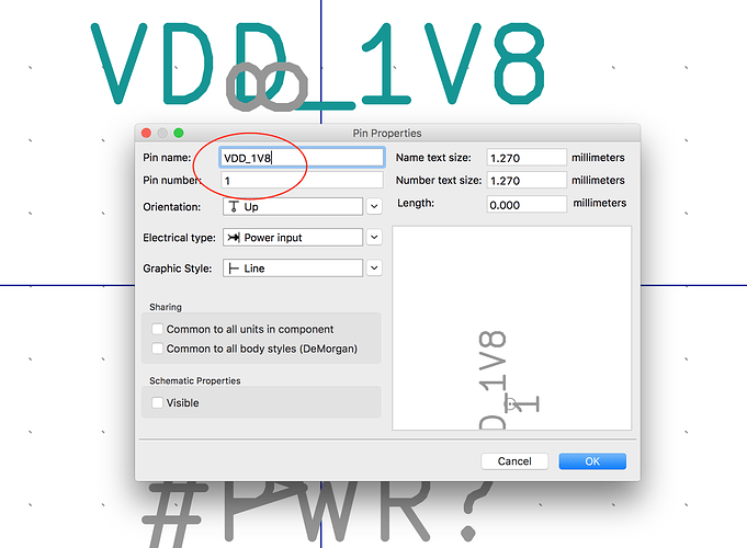

i have multiple power component as i have attached here in this message like VDD_5V,VIO,VDD_MPU,VDDS_DDR and so on there is only one pin to this component and all pins have pin name as VDD when i create a netlist all power pins are connected i thought pin number is important not name but in this case looks like pin name is important as well is it only in case of power component or is it true for all components
only after i renamed the pin name from VDD to VDD_1V8 this issue was resolved
can somebody please explain am i doing something wrong or pin name for power component must be unique
It seems the pin is set to invisible.
Hidden pins are connected if they share a name.

Edit: i missread @Nick123’s post. In short:
Power symbol pin names dictate the net name. (They are used like global labels to connect nets.)
Kicad derides that all hidden power inputs are treated like that.
In this answer and all answers below i wronglyi assumed, that he was talking about a pin of a normal symbol.
thanks rene is it true for all components
rather i renamed the component as i mentioned previously from VDD to VDD_1V8 i hope that should be fine
let me know in case any issue then i can go and set all pin name to visible
In the bug report they talk only about power pins. Maybe pins with electrical types other than power are not connected automatically.

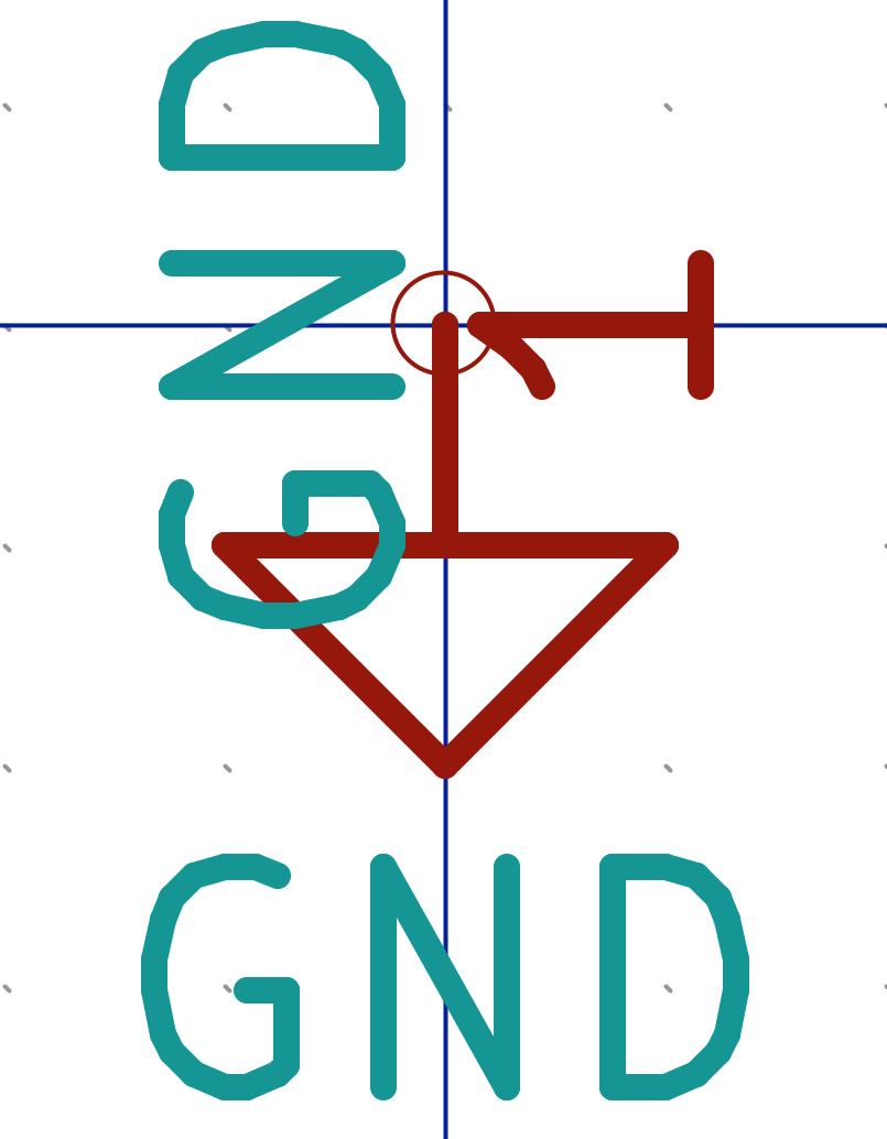

but if i set to visible the ground component has 2 same names one is pin name and other is field value both set to GND which of them is important
please let me know
Power symbols are special. They are treated somewhat like global labels. According to the Transwiki (Powersymbols) pins of powersymbols have to be set to invisible.
Short version from the linked wiki site:
pin invisible and has the name of the desired net name
electrical type is power input
Ref designator starts with #
value the same as net name
under preferences check power symbol.
I think that’s exactly the reason why your invisible power pins got connected. There is no separate pin type for “this is a logical pin” and all invisible power pins are treated as if they are part of a power symbol.
you just now said set them to visible
now why do you suggest to make them invisible again
In symbols which represent parts (Devices that have a footprint): set them to visible. (unless you want the behavior as documented in the kicad documentation. Do be honest you probably don’t want it this way.)
In power symbosl (GND, VDD, …) which are used like global labels: set them to invisible.
that is what was exactly before in the previous image VDD_1V8 it was invisible but all pin names were VDD hence all were connected which is wrong
Ok now i understand, sorry for the confusion.
(I somehow missed that explanation in you post.)
In that case:
Yes powersymbol pin names need to be unique if you don’t want them to be connected.
There you go thanks i have made them unique now
