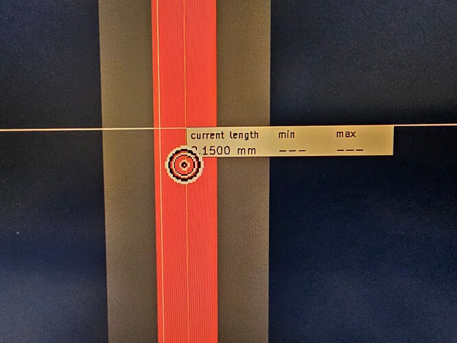

Track lenght visibiliy issue Kicad 9
I have the latest Kicad 9.02. When I turn on “Tune length of single track” or by pressing 7, I get the track measurement tool with a bullseye. However, the bullseye covers the first few digits of the track length measurements. See the image. in older versions the measurement is far enough from the bullseye that it can be seen. Is this a bug or do you guys know of any other options to continue to use the crosshairs instead of the large bullseye? Thank you.

Can you paste your version info here please, you can get it from KiCad > Help > About KiCad > Copy Version Info

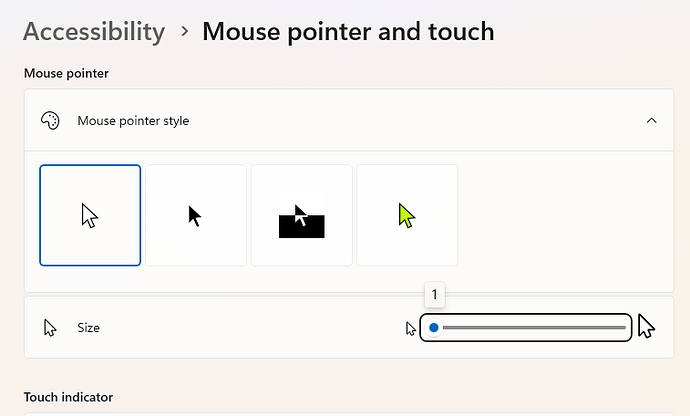

Can you reduce your cursor size in system settings?
I just updated to the latest “testing” version and didn’t see a problem. I investigated possibly related Windows settings but didn’t find a way to change any sizes so that it would affect. If there’s such setting it would be dependent on, for example, the computer brand and extra software which often come with with ready-made computers. I tried resolution, scale, KiCad icon size… Mouse pointer didn’t have size settings in Window 11.
Also the cursor might become too large if the display scaling is too large.
Thank you that solved it! Mine was set to only size 2.
I changed it to 1 and now its visible!
Thank you!
