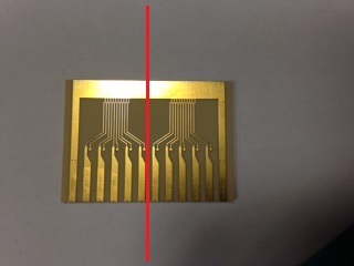

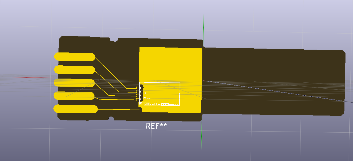

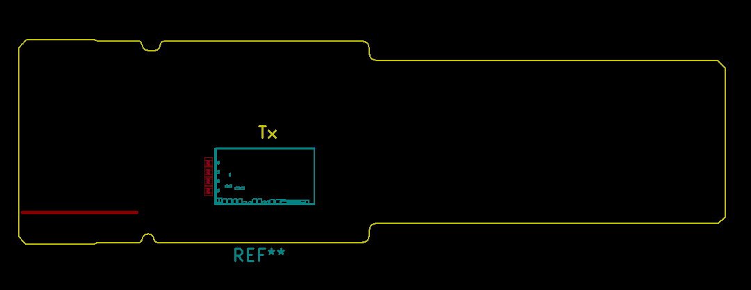

I haven’t made much progess on this and I need to get something soon so I’m changing the requirements for a short term solution. I need to replicate only half of the white PCBA board (pictured) the traces are on the top surface since it’s an edge connected board. I took the measurements so I have the dimensions. What I don’t understand is if this should be copper surfaces (or called copper fills) or traces on the front Cu layer? Traces aren’t exposed so it doesn’t make sense to me. I put a trace as an example of where the first one should be located. I made a footprint of the Tx die with the pads needed. These pads will be Au wire ball-bonded to the Tx die. Any input would be appreciated, thanks!
To expose the copper for the edge-connector, simply place a filled zone on the corresponding mask layer on top. This needs to be done for both traces or copper zones.
I now understand how to do exposed copper but my problem is the copper ground plane is an
“island” and I can’t get the traces to connect to it. I think this has to do with Net list. My problem is I went straight to PCB design, does this mean I need to go back to schematic? Is there a way to get around this?
I extended my traces beyond the edge of the board, will this be ok? I know it’s not the most elegant approach.
Sorry, I thought that might work, but it doesn’t… note to self: always test before post
I guess that the copper in your last screenshot (traces, pads, zones) are all such primitives, no footprints, right?
If you are keen and don’t want to redraw this you can make a very simple schematic with just 2 connectors to get a net, add some pad footprints, create the netlist and get your pcb on track by editing the kicad_pcb file in a text editor to get all those primitives onto that net.
If you send me your kicad_pcb I can do that for you - as I did lead you on the ice there.
